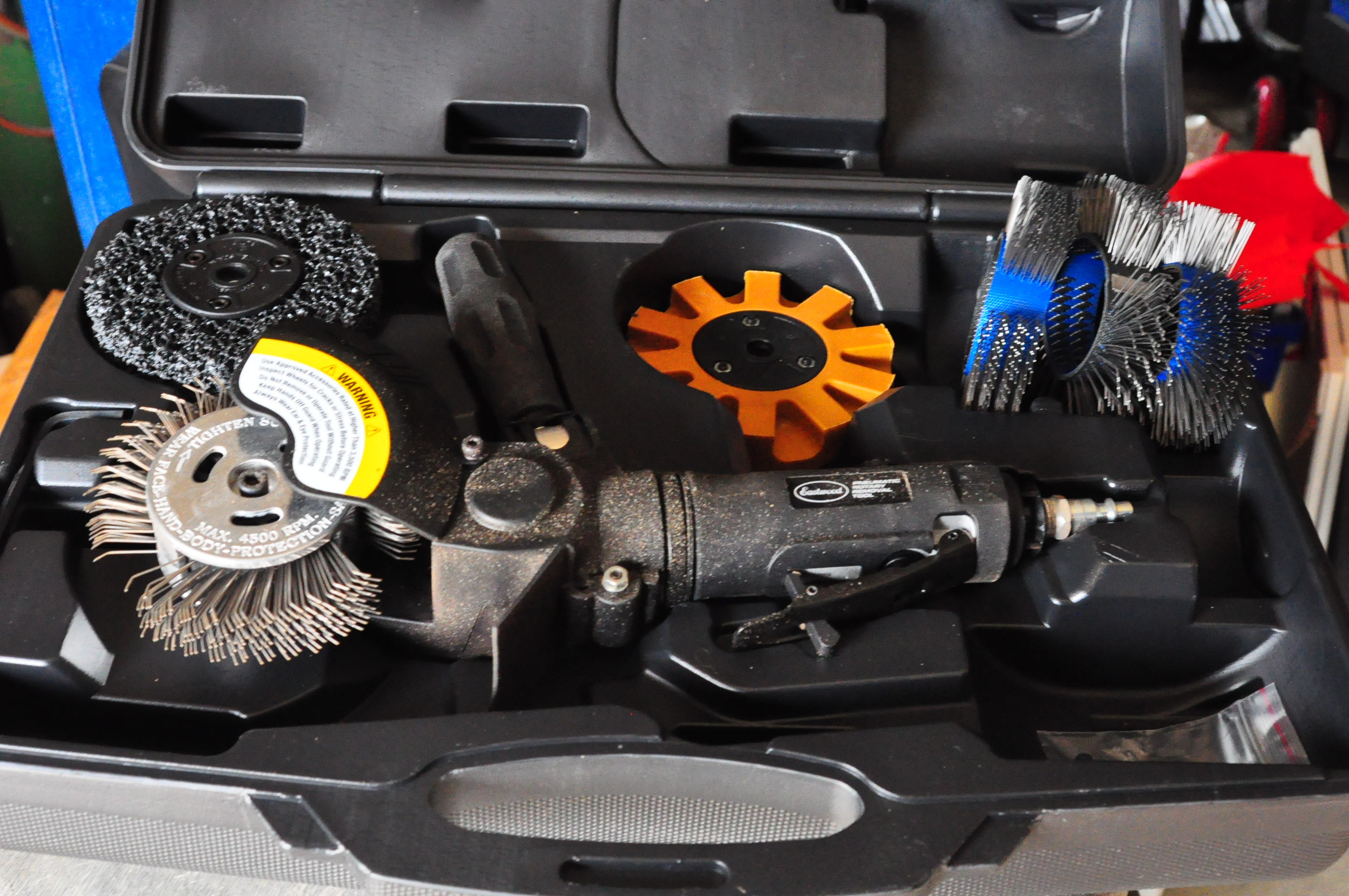

All in all the soda blasting revealed that there are more areas to be addressed than I had hoped. Luckily, it’s only metal. Fortunately, Christmas came early in the form of this amazing tool.

QUOTE(budk @ Dec 1 2015, 06:27 AM) *
What is this tool called?

QUOTE(mepstein @ Dec 5 2015, 08:57 AM) *
Eastwood Pneumatic Rotary Removal Tool
Rotary tool
It's not cheap (it was just on sale for $250 I think), but it pays for itself given how well it works. It's a huge timesaver.

QUOTE(budk @ Dec 5 2015, 09:50 AM) *
Rotary tool
Have you used it on the car? The video wasn't too impressive but if you say real world is good, I believe you.

QUOTE(mepstein @ Dec 5 2015, 10:02 AM) *
Rotary tool
I used it enough to see if it works and it worked great in my test. I've seen it labeled as a Wurth Master - Jeff Hail references it in his Bring out the Dead thread. I've seen it mentioned in a couple other of threads which is why I bought it.
