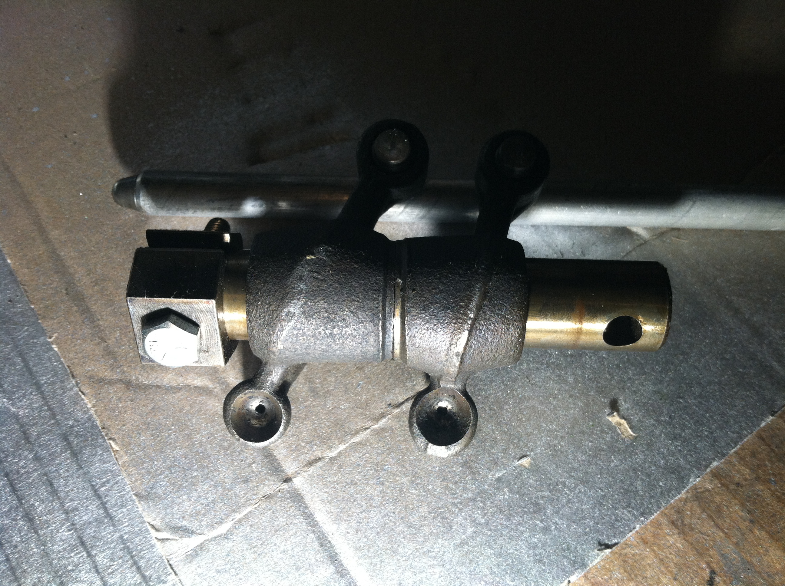

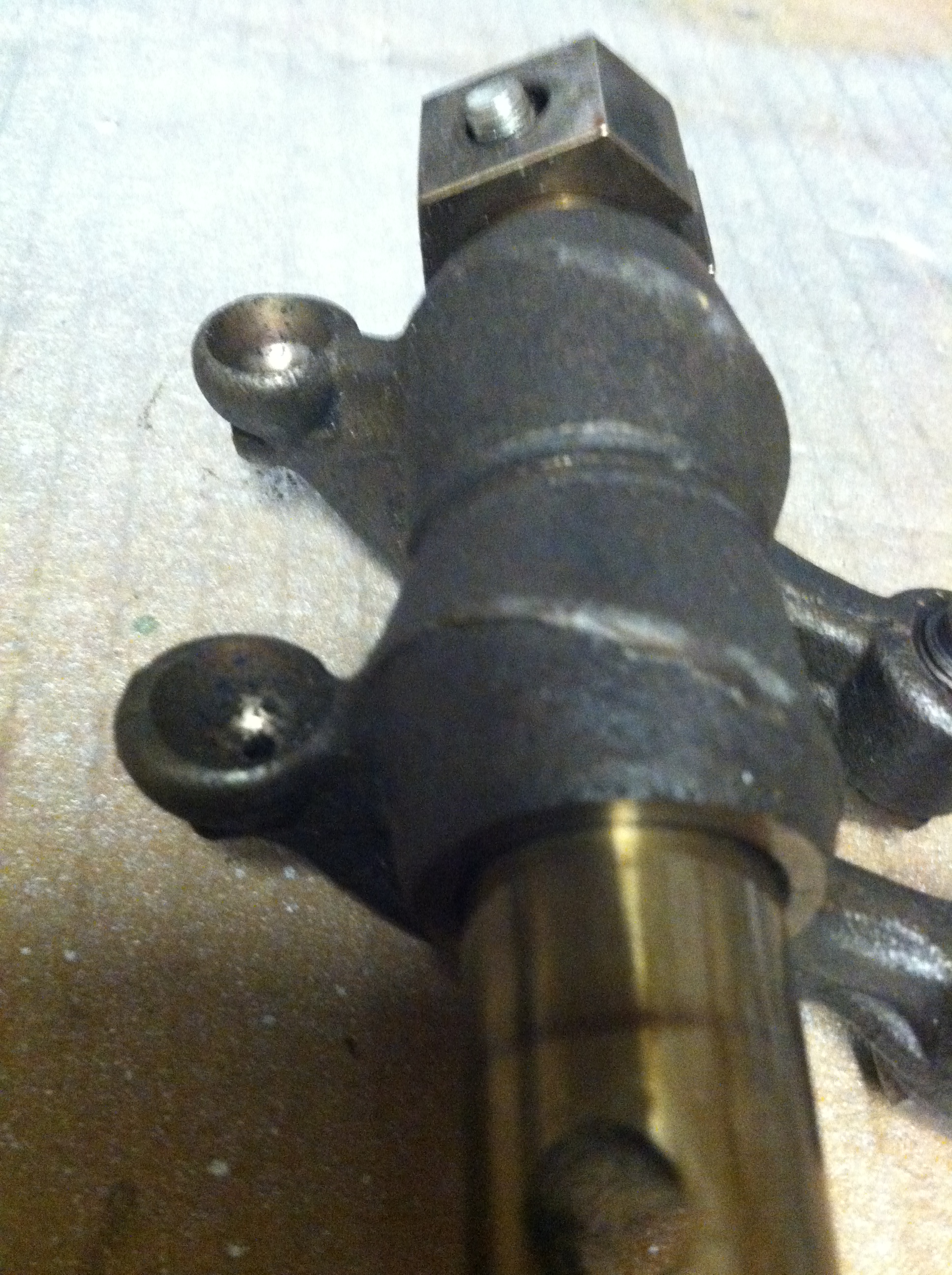

Just getting into cam selection for my street 2056 w/ carbs.
Curious about rocker ratios, so I made some measurements with my dial calipers
on my late 2.0 rockers with the 10mm adjusters and was surprised to see that the intakes & exhausts are different. Just measuring the rockers alone I got 1.41" from center of pivot bore to center of adjuster screw for both in & ex. However the exhaust had 0.92" from the center of pivot bore to center of pushrod cup while the intake dimension was 1.02"
This results in an exhaust ratio of 1.53 & intake ratio of 1.38.
Note that these are eyeball estimates with the rockers laid horizontal as I did not have height stand or CMM equipment to use.
I don't know what ratio the earlier 1.7 rockers are and if different from intake to exhaust, anyone have this info ??
It seems like folks like to use the early 1.7 rockers fitted with swivel foot 911 adjusters

barefoot
post Dec 7 2015, 08:50 PM
Posts: 1,560
Joined: 19-March 13
From: Charleston SC
Member No.: 15,673
[quote name='stugray' date='Dec 7 2015, 08:31 PM' post='2274588']
[quote name='barefoot' post='2274491' date='Dec 7 2015, 03:34 PM']
[quote name='stugray' post='1818427' date='Feb 11 2013, 12:13 AM']
[quote]It is not possible that you are the first to discover the rocker ratio is different than what everyone has believed for 40 years.[/quote]
Chris - I had three reputable machine heads sit and watch the dial indicator "go-round and round" and measured .520 on two different cylinders and after swapping out the rockers from two different engines. (more than FIVE separate measurements). The cam lift is .368 per Jakes cam card and measurement ....
I have two complete sets of 1.4 Intake rockers. Exhaust rockers measure closer to 1.3.
Stu
[/quote]
[/quote]
Sorry BOB says that you are wrong regardless of what you measured:
[quote name='bobhasissues' post='1786515' date='Dec 18 2012, 08:40 PM']
Stu,
Nobody will try to help you if you continue with your argumentative attitude.
MY Raby cam card shows the peak cam lift and peak valve lift based on 1.3 rocker ratios. I would think your card shows the same.
All factory Type IV lifters regardless of 1.7, 1.8 or 2.0 have a 1.3 ratio. Go with 1.3, stop trying to re-evaluate a known value.
Jake's article explains that shims and pushrod lengths will affect total lift.
Look at the value for peak lift valve on your cam card and shoot for that.
[/quote]
So according to Bob, your measurements are wrong (even though what I measured was about the same).
My measurements were with the rockers actually moving the valves on the engine so I would expect yours to be a little different.
Of course my measurements are "static" and as previously described "dynamic ratio is a variable as rockers tilt, so cam producers have to settle on an average figure.
However there's clearly a difference in intake to exhaust rocker design as the photos show.
BTW this was constantly observed from rockers off 2 different 2L motors. i have no history on these, but assume them to be OEM.
