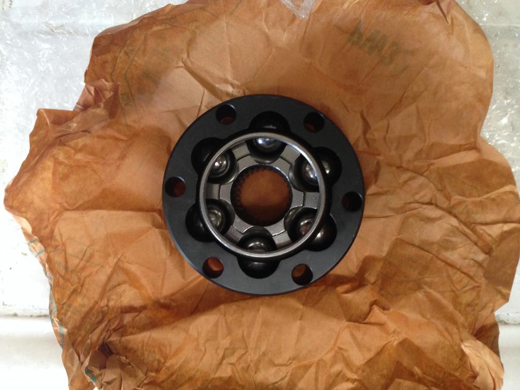

I went over to Blind Chicken Racing and looked up CV Joints 101. The 914 CV is a slightly modified Type 1 joint. Type 1 shows to have 12 degrees of articulation. Going to update to 911SC rear stubs and hubs requiring 100mm CV joints. Type 4, Thing 181, 924/944 are all 100mm with 22 degrees of travel. VW Bus and Vanagan are 100mm too but with 17 degrees of travel.
Bus CV joints are about 1/2 the price of 924/944 with 5 degrees more travel than the stock 914. Any reason they would not be more than heavy duty enough for the job?

Ultimate 108mm CV
http://www.rcvperformance.com/product-deta...spx?sku=SI-15RF
Must use a sliding axle but comes with a "no questions asked lifetime warranty".
I have these with 300M cages so I son't think they will ever break.
