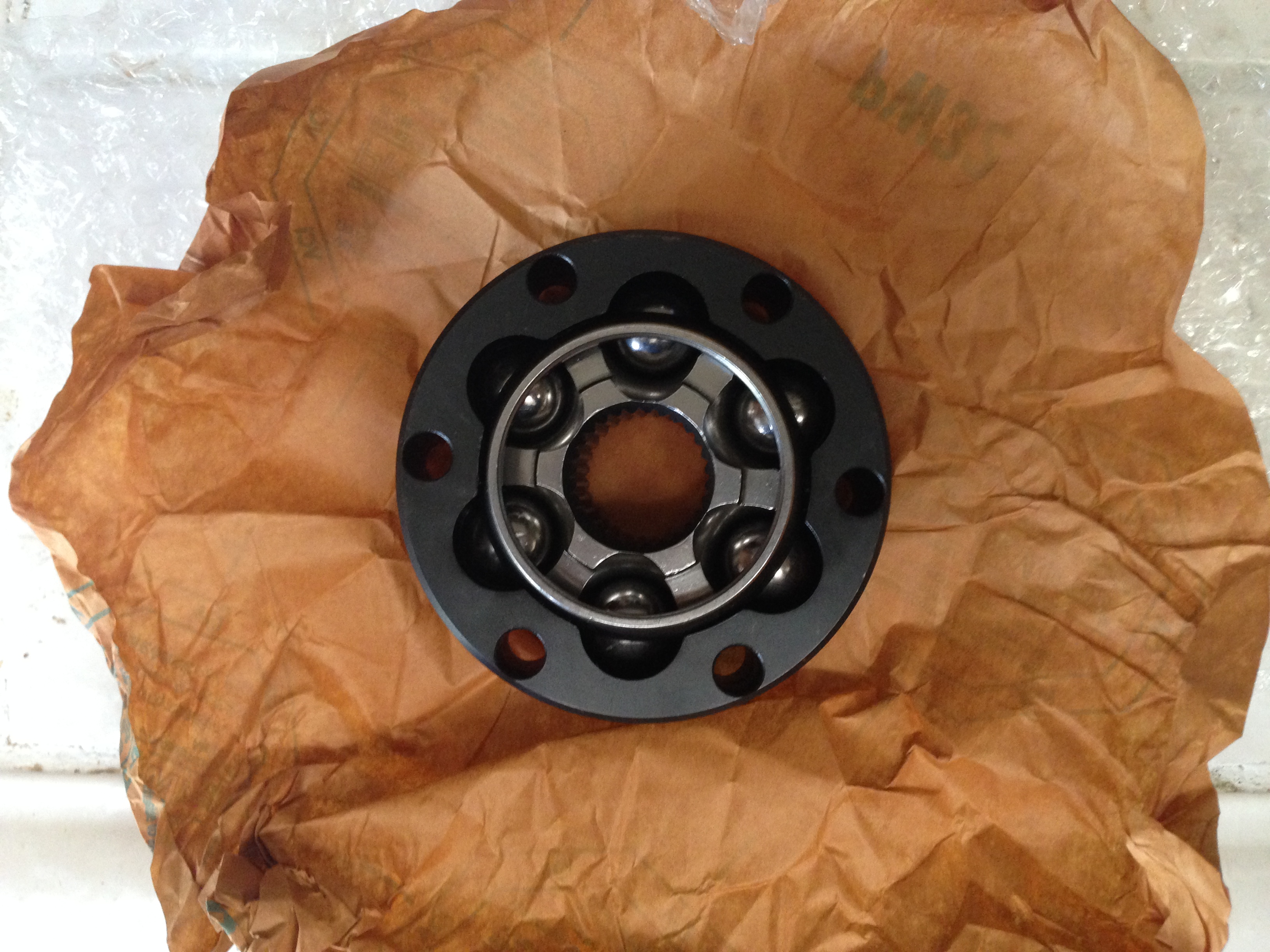

914Sixer   OK, the 100mm bus CV's came in today. Disasse...   Dec 7 2015, 07:12 PM
