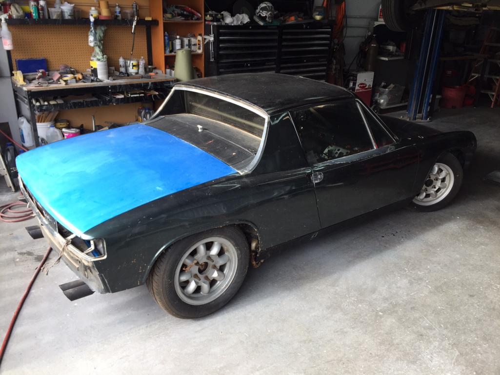

I just took the car to the body shop to have steel GT flares added.
going to strip the body and repaint it also.
I need to buy F/G lids for it now.....
