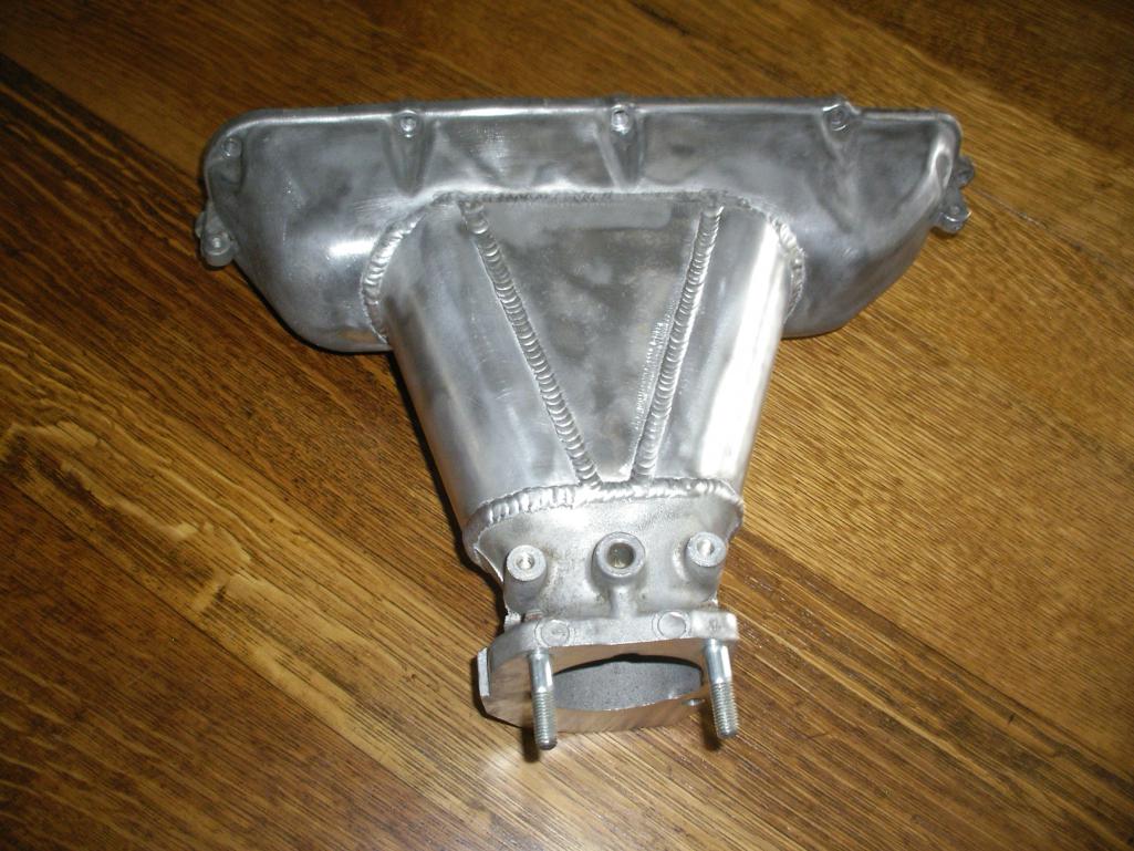

Thought I'd put up a few photo's of my current 914 project. I had a six from 1984 to 1998; started with the 2.0 T, then a 2.0S, to a 2.7, and finally a 3.0, with RSR pistons, Solex cams and a few other tweaks. She was a blast to drive, and I drove her to work, and vintage raced her for many years. About six years ago the 914 urge returned, and I built a few V8 cars, one with a LS, the other with old school SBC. They were both cool, and super fast, but just didn't sound right, so I began thinking of another six. Once the price shock passed, I knew it wasn't going to be a Porsche six, and started learning about some alternatives, and settled on the Honda 3.5 V6 from the Pilot, etc. They are all aluminum, variable valve timing, compact, light, and dirt cheap, and make around 250HP, and Ft. Lbs, a nice level for a 914. And happily, Kennedy makes the adapter kit, so that part is out there.
After a trip to the junk yard to look at, and measure, it seemed close enough to bring one home, and really start playing with it. I am aware of one other 914 with this engine in it, but it's a solo car, with out a trunk floor, etc., so one problem fitting it in. I have a nice 20K original car, too nice to start cutting up, so if the engine wouldn't go in, I'd give it up. (The car was a V8 car almost from new, don't panic!).
The engine is very compact, but the intake spreads out over the gearbox, and would stick way into the trunk. Fortunately, the intake can be flipped 180 deg., and by cutting off the throttle body, and re-welding it onto the side, the engine becomes nice and workable. It is a tight squeeze, but fits almost like it was designed to be there.Attached Image Attached Image

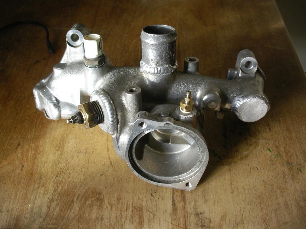

The intake and water passage mods: Because the dune buggy guy's are using this engine, there are sources for de-bugging the ECU, and the main things you have to do to make the install work, are the pictured mods, and making a front engine mount.

siverson   Neat! And thanks for posting. Are those your ...   Dec 19 2015, 03:10 PM
914bub   I'll be watching this for sure. Those engines ...   Dec 19 2015, 03:12 PM
tomrev   I"m looking forward to hearing it; the firing...   Dec 19 2015, 03:15 PM
Cracker   Looks good...how much does the complete engine wei...   Dec 19 2015, 03:13 PM
tomrev   Looks good...how much does the complete engine wei...   Dec 19 2015, 03:18 PM
