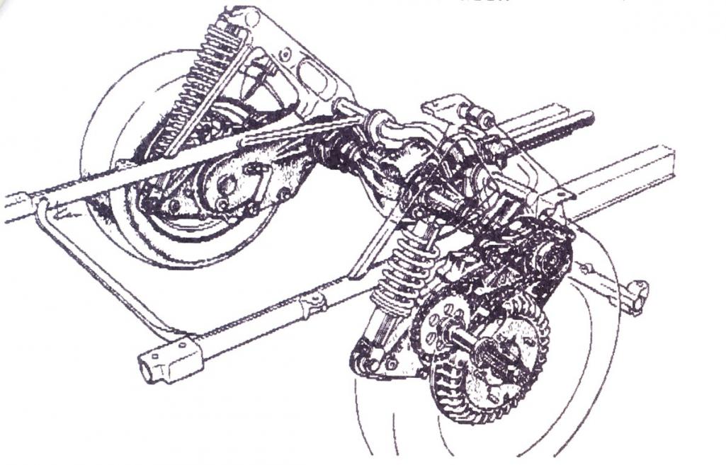

I thought about that also since I worked in a major Honda dealership in the shop. I took the measurements and after you line up the max angles for the CVs and get the trans where it's not dragging on the ground, you end up with the engine partially in the trunk and sticking out about 5 inches worth. I hated to give up on the idea because it's such a sweet package all in one - plus you could call it a Pornda... (IMG:style_emoticons/default/shades.gif)
Insert Hijack (IMG:style_emoticons/default/smile.gif)
You could have used chain drive like the S600
