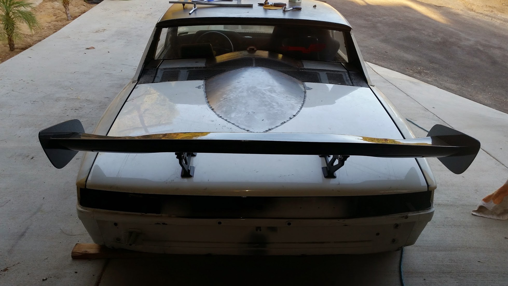

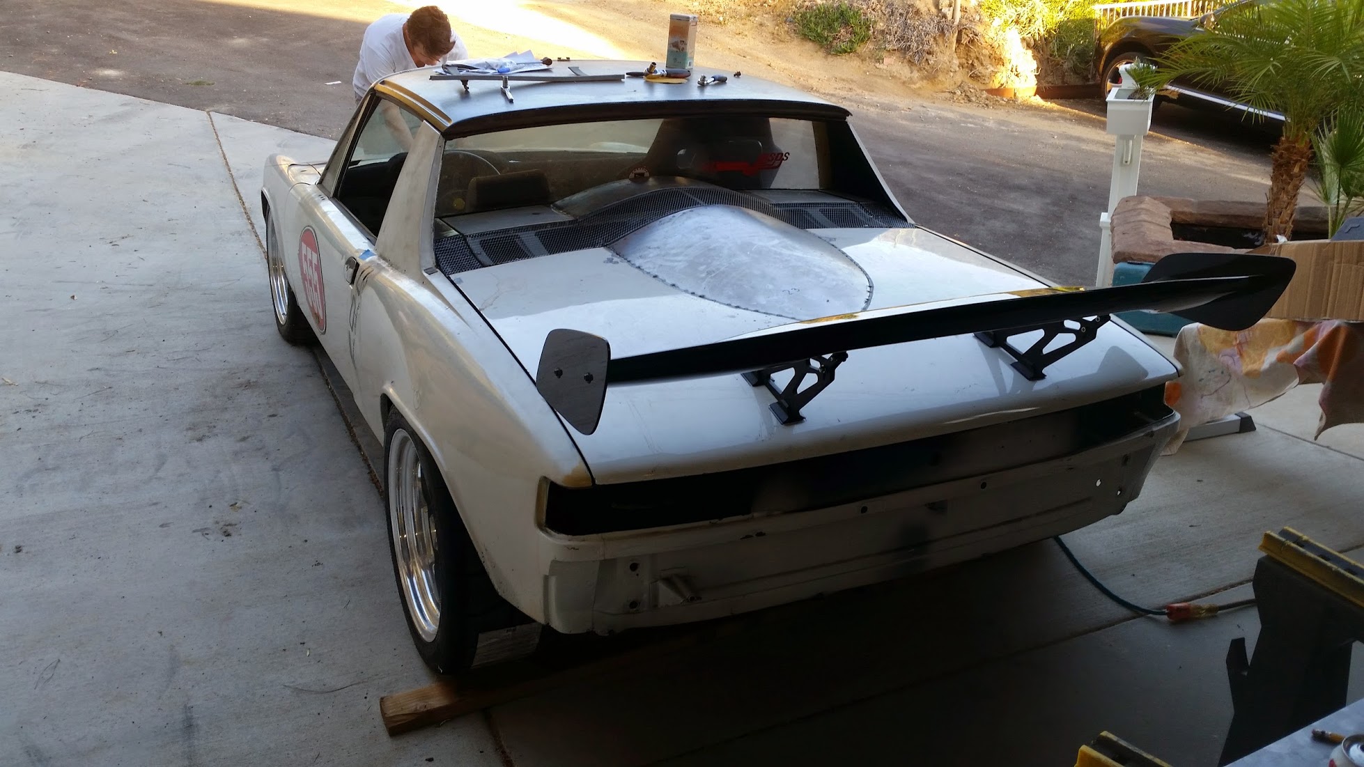

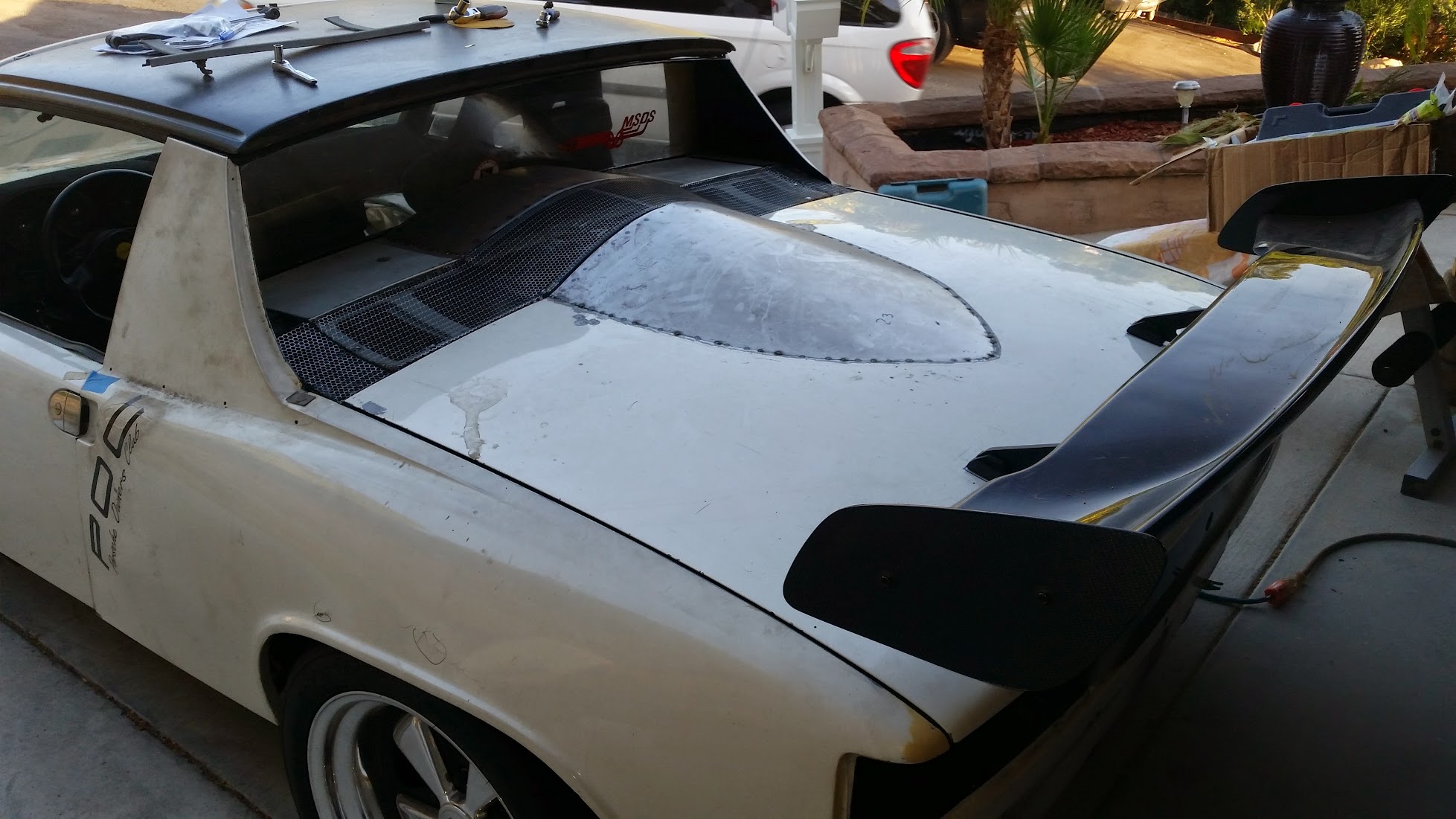

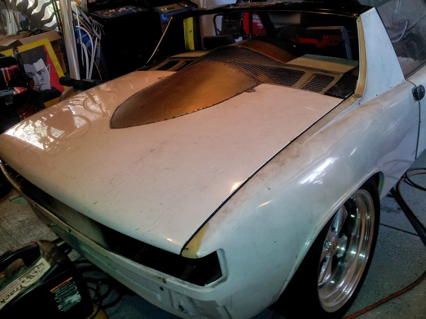

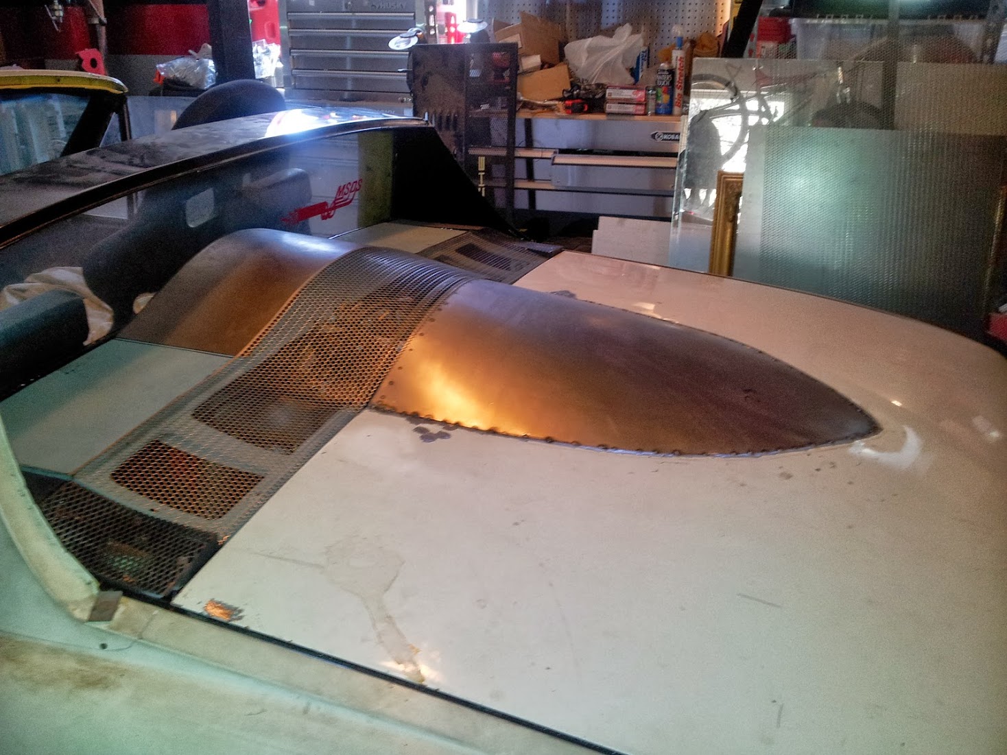

Converting over to the 3.6 V-ram presents new obstacles in covering over the high point of this engine. This customer had drawn up several solutions, and decided on the single hump.
Kind of like one of the 2 humps on the Carrera gt. The shape will continue into the mesh area of the grill, with the actual mesh shaped to match.
New technique: Form follows horsepower.
MartyAttached Image

Maltese Falcon   3.6 Varioram conversion   Aug 5 2013, 09:30 PM
Maltese Falcon   Another, playing around with the Porsche crest...   Aug 5 2013, 09:33 PM
speed metal army   Funtion before fashion! :headbanger: Is there...   Aug 5 2013, 09:46 PM
Maltese Falcon   And for big track at Willow Springs   Aug 5 2013, 10:06 PM
396   Very creative solution !   Aug 6 2013, 09:58 AM
Cap'n Krusty   Nice solution. However, slapping Porsche crests a...   Aug 6 2013, 10:03 AM
Maltese Falcon   Nice solution. However, slapping Porsche crests ...   Aug 6 2013, 11:24 AM
DBCooper   ...slapping Porsche crests all over the place is ...   Aug 7 2013, 02:11 PM
ConeDodger   Nice solution. However, slapping Porsche crests ...   Aug 7 2013, 04:49 PM
Cairo94507   Not something I would go for. But assuming functi...   Aug 6 2013, 10:35 AM
McMark   Interesting approach. It looks like the engine is...   Aug 6 2013, 10:53 AM
Maltese Falcon   Interesting approach. It looks like the engine i...   Aug 6 2013, 11:06 AM
396   Interesting approach. It looks like the engine ...   Aug 6 2013, 01:41 PM
SirAndy   :idea: On my car, we modified the plenum so the ...   Aug 6 2013, 11:16 AM
ConeDodger   :idea: On my car, we modified the plenum so the...   Aug 7 2013, 04:53 PM
SirAndy   :idea: On my car, we modified the plenum so the ...   Aug 7 2013, 06:54 PM
r_towle   Laser cut the hump to be a big ass porsche crest.....   Aug 6 2013, 12:56 PM
Maltese Falcon   0396, utilizing an aftermarket mount I could modif...   Aug 6 2013, 06:17 PM
rgalla9146   0396, utilizing an aftermarket mount I could modi...   Aug 6 2013, 10:57 PM
396   0396, utilizing an aftermarket mount I could modi...   Aug 7 2013, 05:04 PM
mepstein   Any other pics or info on the build?   Aug 7 2013, 05:06 PM
Maltese Falcon   Any other pics or info on the build? More pics a...   Aug 7 2013, 08:58 PM
Elliot Cannon   My guess is, that will be one fast MO FO! If ...   Aug 7 2013, 11:07 PM
