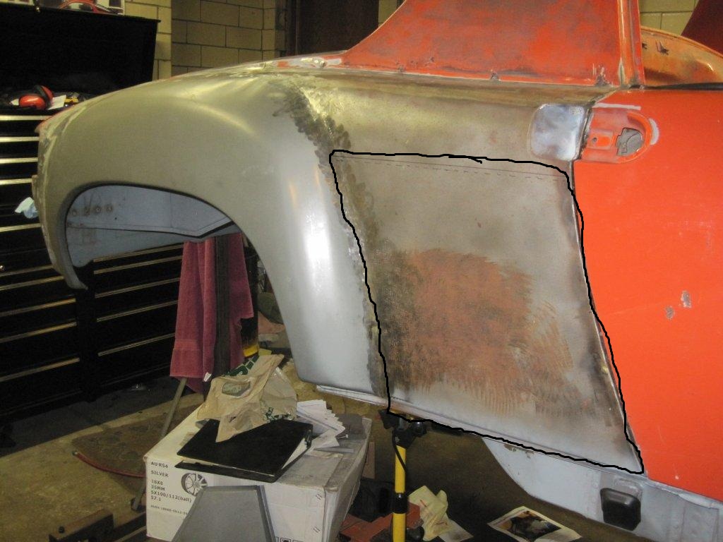

I would like to find a good condition right rear fender section to replace the section that is outlined in the picture below. I already have the top section that I got from Restoration Design some time ago. I need to replace this area due to poor repair that was done sometime in the past.
Does anyone have the section of fender that is outlined in the picture that is in good condition?

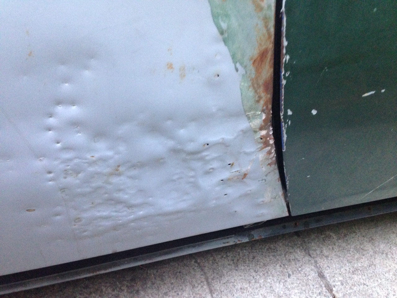

I have the exact same area behind the passenger door to replace. I do have a good quarter panel but I'm using it obviously. I look forward to seeing your repair work on this! Good luck! Here's my same damaged area. Attached Image
