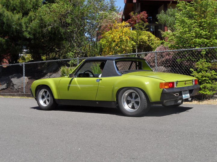

Looking to buy some Euromeisters and all I see is 7's and 9's in 17" rims. Do the 17x9's fit in the rear with AA steel flares? If not, do they need major work (grafting in metal) or just some tugging.

i do luv my 15 x8 x9
that is 245/50 x 15 re71's

bfrymire   I have the same rims, except they are 16x9. And t...   Dec 22 2015, 02:37 PM
Steve   I'm running Fixse 17x9. I have no problems fi...   Dec 22 2015, 02:39 PM
SirAndy   Do the 17x9's fit in the rear with AA steel fl...   Dec 22 2015, 03:06 PM
snakemain   17x9s Rota Fox Fuchs reps with 245/40 in the rear ...   Dec 22 2015, 03:29 PM
Series9   The RS has 17x9 Cup IIs with 255 rubber. We rolle...   Dec 22 2015, 03:34 PM
andys   The RS has 17x9 Cup IIs with 255 rubber. We roll...   Dec 22 2015, 06:52 PM
rick 918-S   John, I have a 10mm spacer on the rear to clear th...   Dec 22 2015, 03:49 PM
Elliot Cannon   Spacered to fit. QRS fiberglass fenders. 17X9.   Dec 22 2015, 04:05 PM

jmill   17x9s Rota Fox Fuchs reps with 245/40 in the rear...   Dec 22 2015, 04:47 PM
snakemain   17x9s Rota Fox Fuchs reps with 245/40 in the rea...   Dec 22 2015, 06:54 PM
jmill   Rear offset is 16mm. I believe that is stock 911 ...   Dec 22 2015, 04:54 PM
Cracker   John - I'd take the subjective opinion that 17...   Dec 22 2015, 05:18 PM
jmill   Tony, are those the RSR finish Rota Foxes? If so ...   Dec 22 2015, 05:44 PM
pete000   I agree the 17's are just too big for the 914....   Dec 22 2015, 05:53 PM
Cracker   They may be the same but mine are called Linea Cor...   Dec 22 2015, 05:53 PM
bfrymire   Cracker, Your flares look different than mine, lo...   Dec 22 2015, 06:24 PM
Cracker   Brett - Yes. Mine are modified/custom. Also, the H...   Dec 22 2015, 07:40 PM

jmill   They do look good but tire selection in the 15 and...   Dec 23 2015, 10:51 AM
d914   with 9 in wide rims I believe the offset should be...   Dec 23 2015, 12:19 PM
PotterPorsche   Rota fox -euromiesters same thing right? http://w...   Dec 24 2015, 10:13 AM
jmill   Rota fox -euromiesters same thing right? Yes a...   Dec 24 2015, 06:46 PM
Cracker   I bought mine from Wheeldude.com - I might of over...   Dec 24 2015, 06:55 PM
carr914   RE: AA Steel Flares and 17x9's in Rear   Dec 25 2015, 05:21 AM
Garland   Euromeister 16x9 15mm ET, AA steel flares. 245-50x...   Dec 25 2015, 08:49 AM
