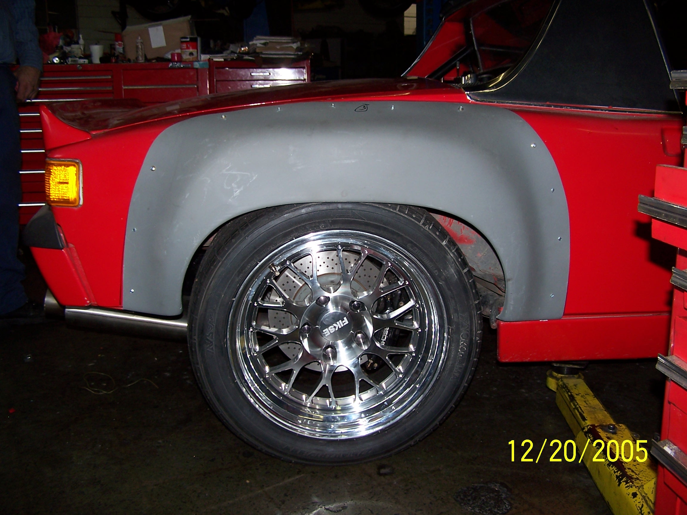

Looking to buy some Euromeisters and all I see is 7's and 9's in 17" rims. Do the 17x9's fit in the rear with AA steel flares? If not, do they need major work (grafting in metal) or just some tugging.

I love my Fikse 17" rims too. Some 17" rims don't look right, but IMHO the Fikse's look great.

Steve   I'm running Fixse 17x9. I have no problems fi...   Dec 22 2015, 02:39 PM

rick 918-S   John, I have a 10mm spacer on the rear to clear th...   Dec 22 2015, 03:49 PM
Elliot Cannon   Spacered to fit. QRS fiberglass fenders. 17X9.   Dec 22 2015, 04:05 PM
