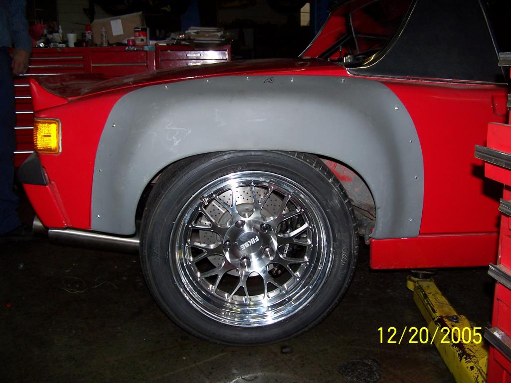

Looking to buy some Euromeisters and all I see is 7's and 9's in 17" rims. Do the 17x9's fit in the rear with AA steel flares? If not, do they need major work (grafting in metal) or just some tugging.

914 Guru ![]() ![]() ![]() ![]() ![]() Group: Members Posts: 6,026 Joined: 14-June 03 From: Laguna Niguel, CA Member No.: 822 Region Association: Southern California
I love my Fikse 17" rims too. Some 17" rims don't look right, but IMHO the Fikse's look great. |

Steve I'm running Fixse 17x9. I have no problems fi... Dec 22 2015, 02:39 PM
