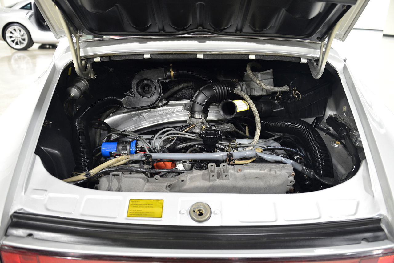

I should go back a reread this whole thread...bizzarro...what else can be said? Looks like you have a 912E engine or at least some of its injection system, with a 5-pole D-Jet TPS connector morphed into it for who knows what purpose. Here is a photo of a 912E engine/fuel injection if it of any assistance. I have more photos if you need them.
I also have downloadable D-Jet and L-Jet Fuel Injection manuals (including 912E) here:
http://bowlsby.net/914/Classic/TechNotebook.htm
