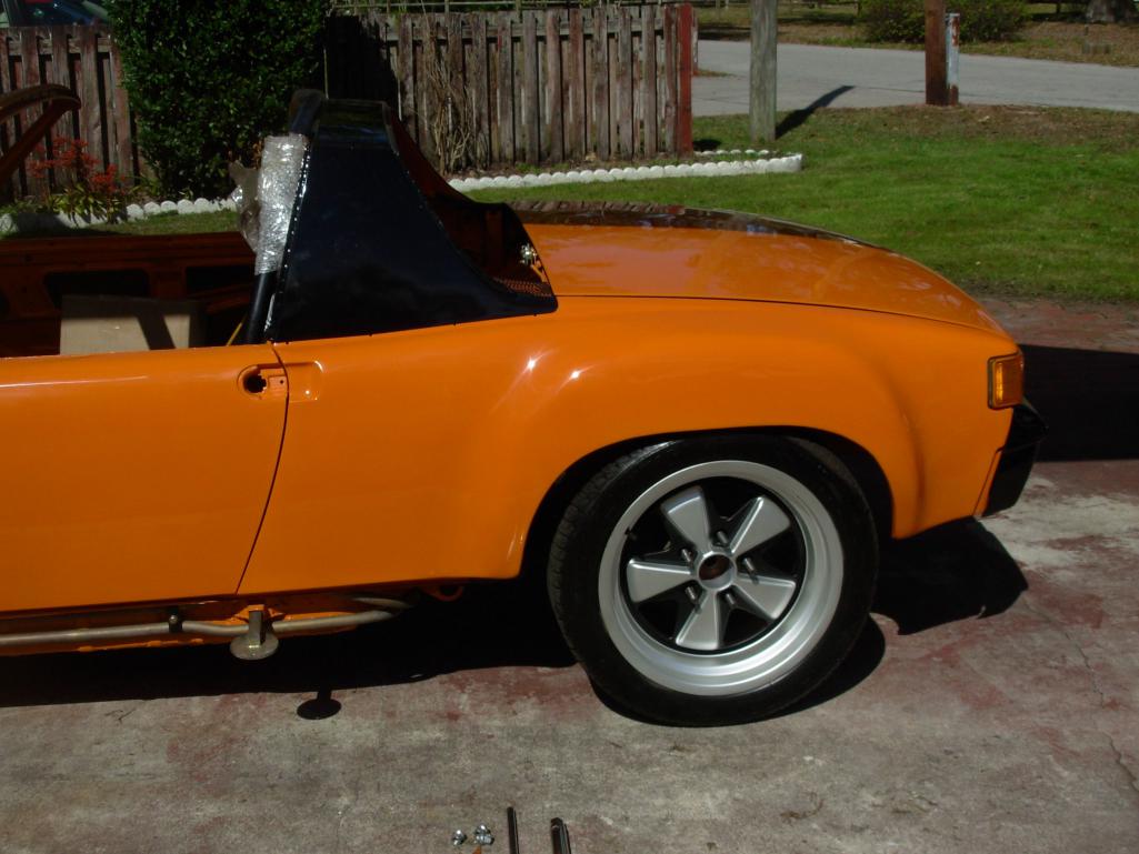

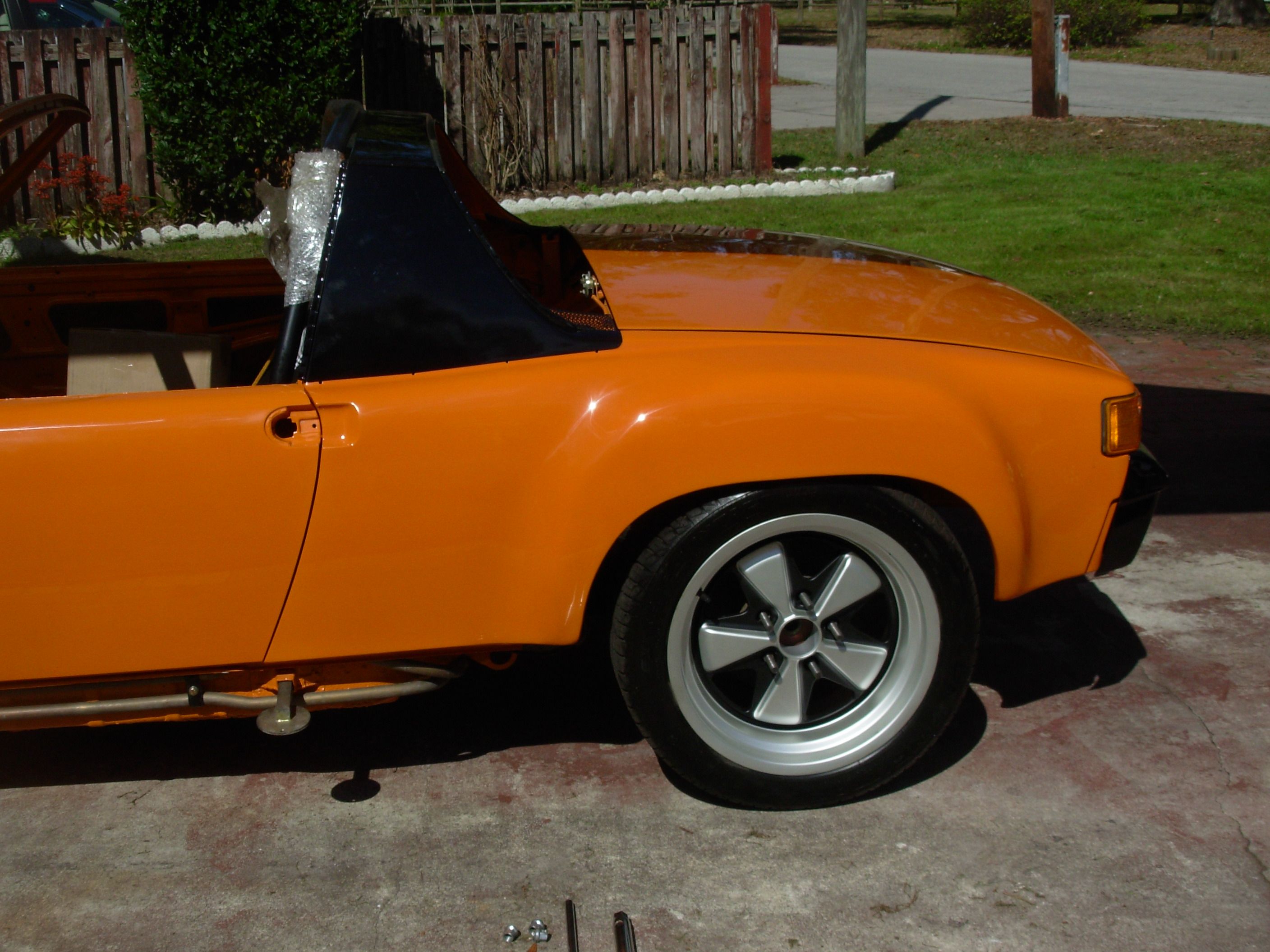

Elliot Cannon Spacered to fit. QRS fiberglass fenders. 17X9. Dec 22 2015, 04:05 PM
