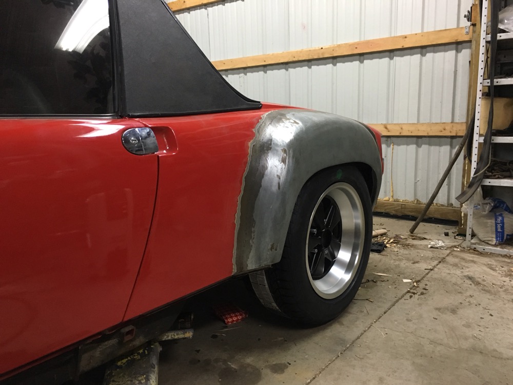

Looking to buy some Euromeisters and all I see is 7's and 9's in 17" rims. Do the 17x9's fit in the rear with AA steel flares? If not, do they need major work (grafting in metal) or just some tugging.

Euromeister 16x9 15mm ET, AA steel flares. 245-50x16 had to trim the lip on the flare for clearance.

Garland   Euromeister 16x9 15mm ET, AA steel flares. 245-50x...   Dec 25 2015, 08:49 AM
