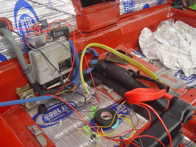

Guys,
I have multiple electrical add-ons that came on the -6 I'm now considering removing:
Aiwa stereo and amp
Derringer VS8300 alarm system
voltmeter
driving/mileage computer
remote trunk release
fuel pump oil pressure bypass
power windows
power mirrors
The PO was an electrical engineer but his "wiring skills" are questionable. I lowered the fuse panel today afraid of what I would find and saw this:
I am no wiring genius and looking at this mess is quite daunting! The problem is that all of this was installed back in the mid-80s and there is so little documentation of the mods included in the records I have. And even looking at the installation instructions for the alarm, I can see that the wire colors included in the instructions don't line up with the way the alarm was wired. The alarm is tied into the starting circuit so I'm concerned that I might disable the car and have a tough time getting it running again.
I through about checking with a local alarm / stereo installation shop but I'm not sure if they could handle it without full documentation.
The only way I know how to do this is to take pics and notes before I undo each wire and start with the simplest add-on first.
Any other recommendations / thoughts?

WOW ... (IMG:style_emoticons/default/wacko.gif)

QUOTE(SirAndy @ Dec 11 2015, 07:11 PM) *
I may be a guilty party. However I will be writing schematics.

db9146   Well, it took a while and at times over the last s...   Dec 11 2015, 08:58 PM
somd914   Well, it took a while and at times over the last ...   Dec 11 2015, 09:56 PM

914Sixer   I built custom vans in the 70's and quickly le...   Dec 12 2015, 12:49 PM
Unobtanium-inc   I remember back in high school we used to install ...   Dec 13 2015, 11:47 AM
Cairo94507   db9146 - Great job. I would have done the exact s...   Dec 13 2015, 10:03 PM
skier2.0   Loved the 80's   Dec 25 2015, 06:33 PM
NeunEinVier   Making flags using white cloth tape (or white ...   Dec 30 2015, 12:53 PM
