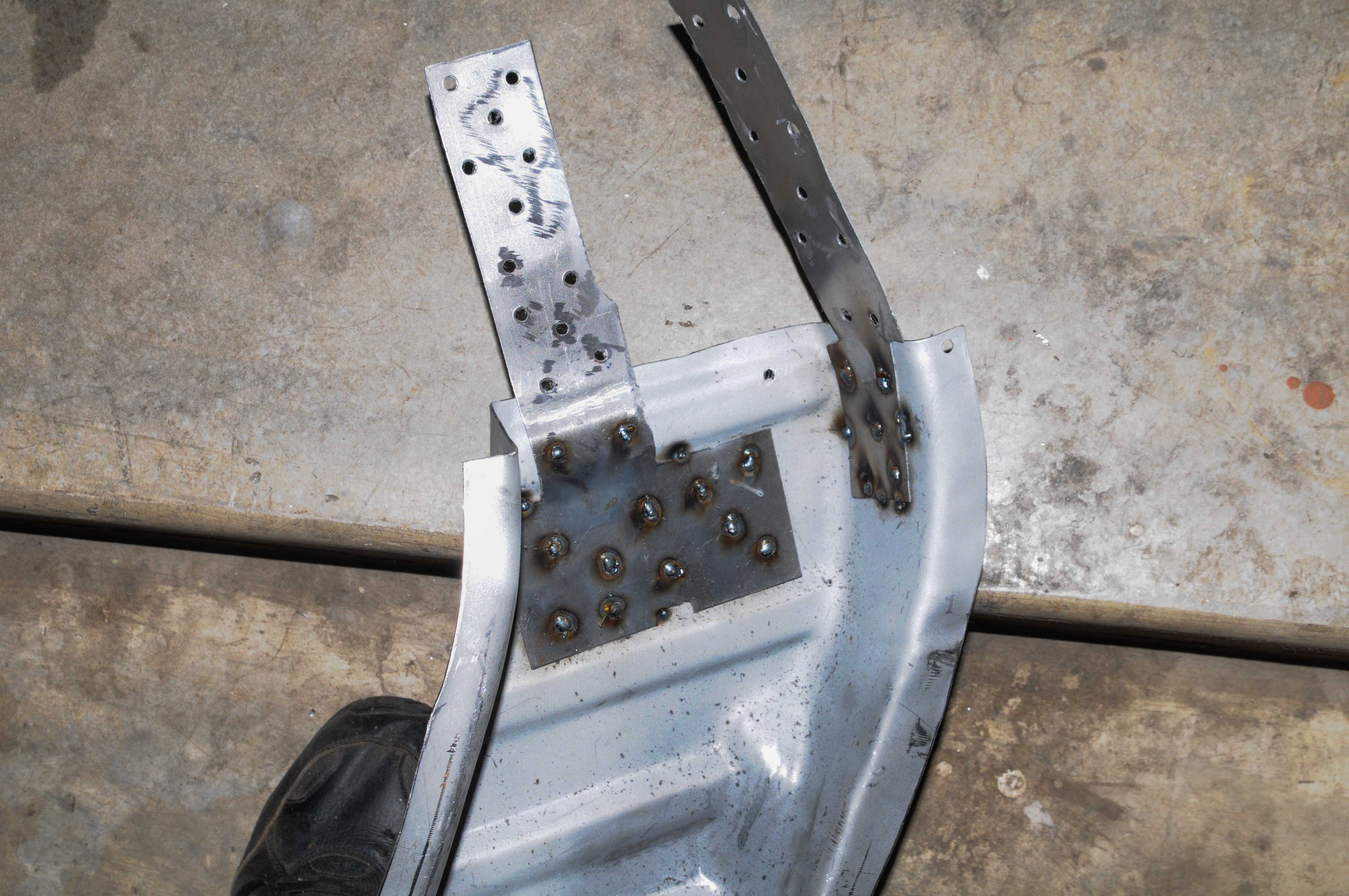

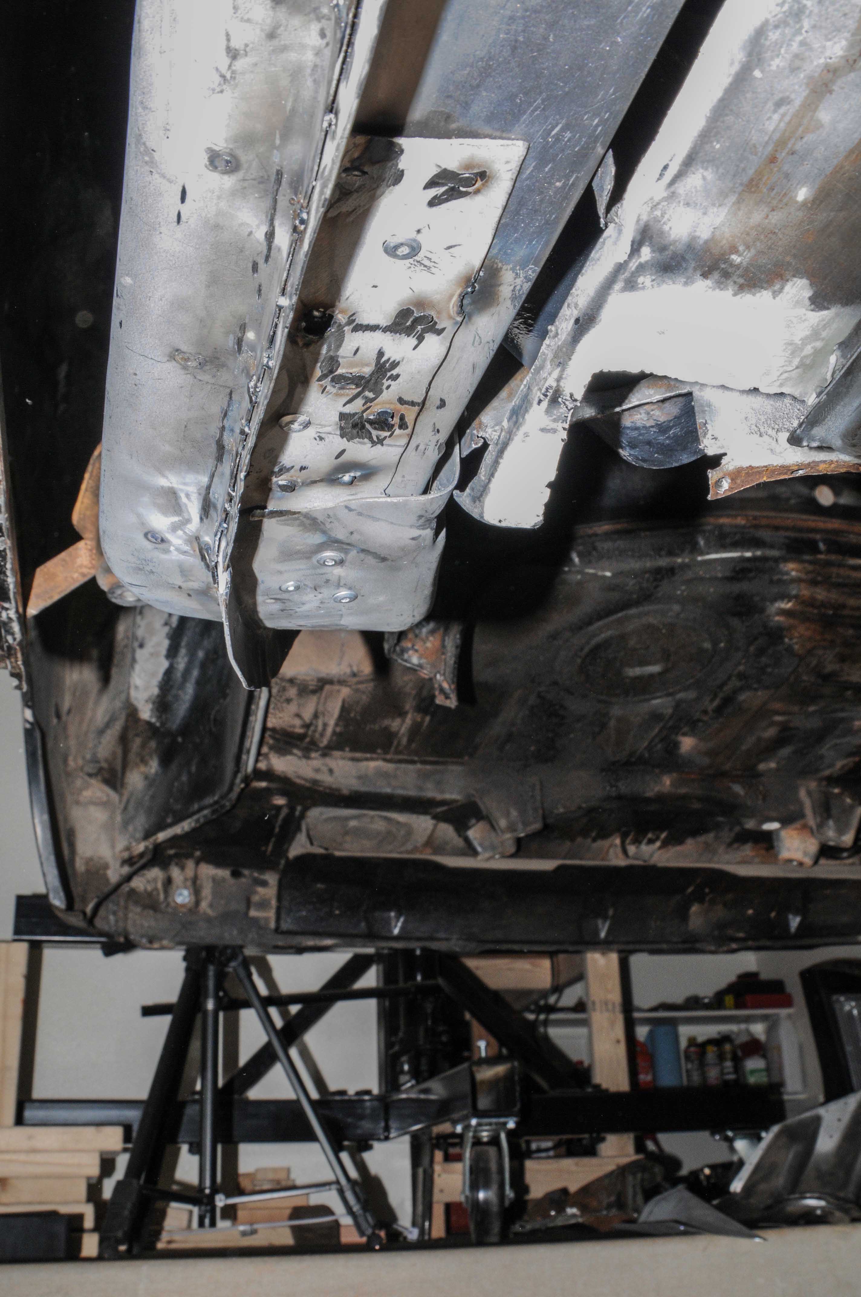

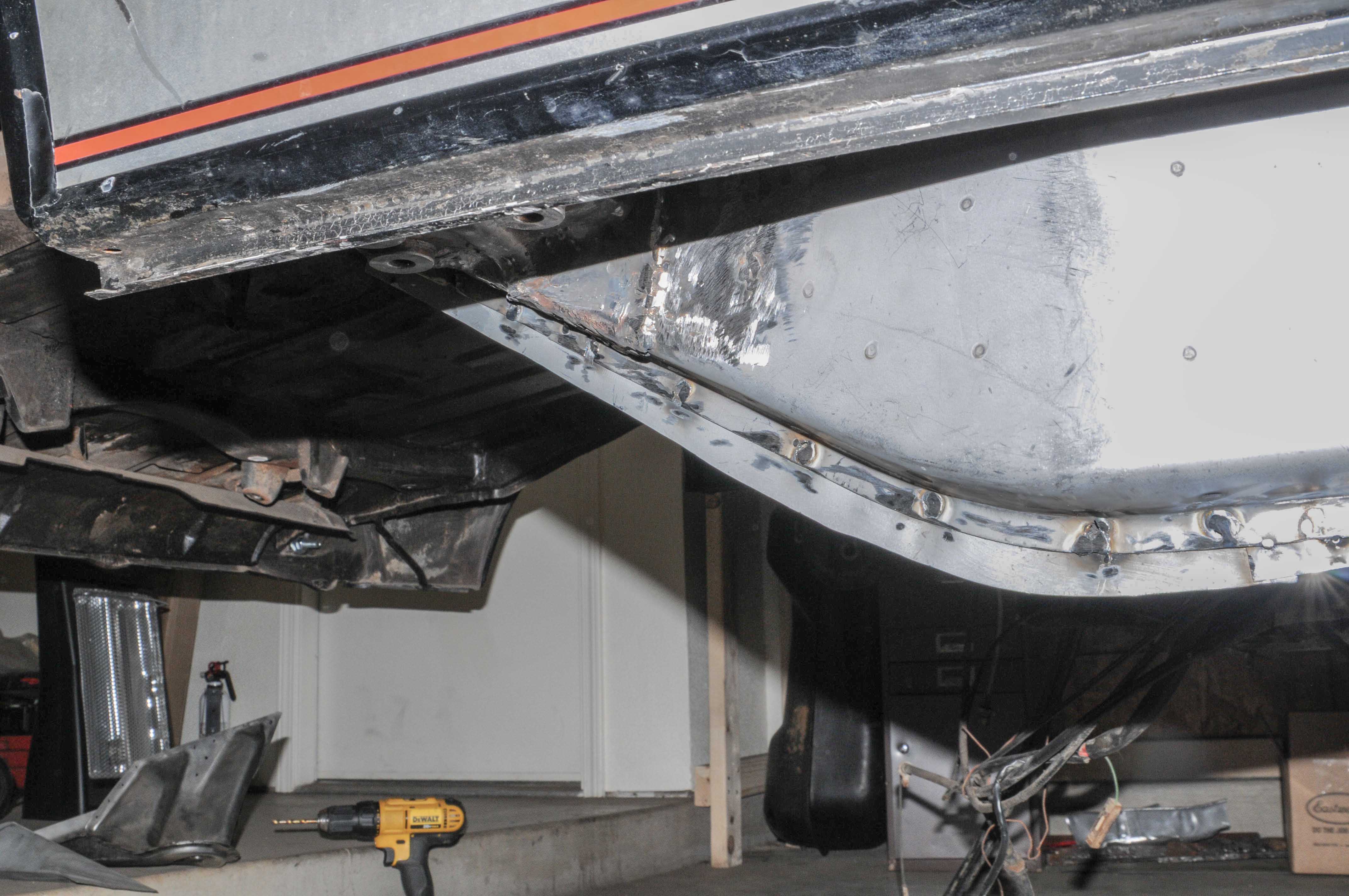

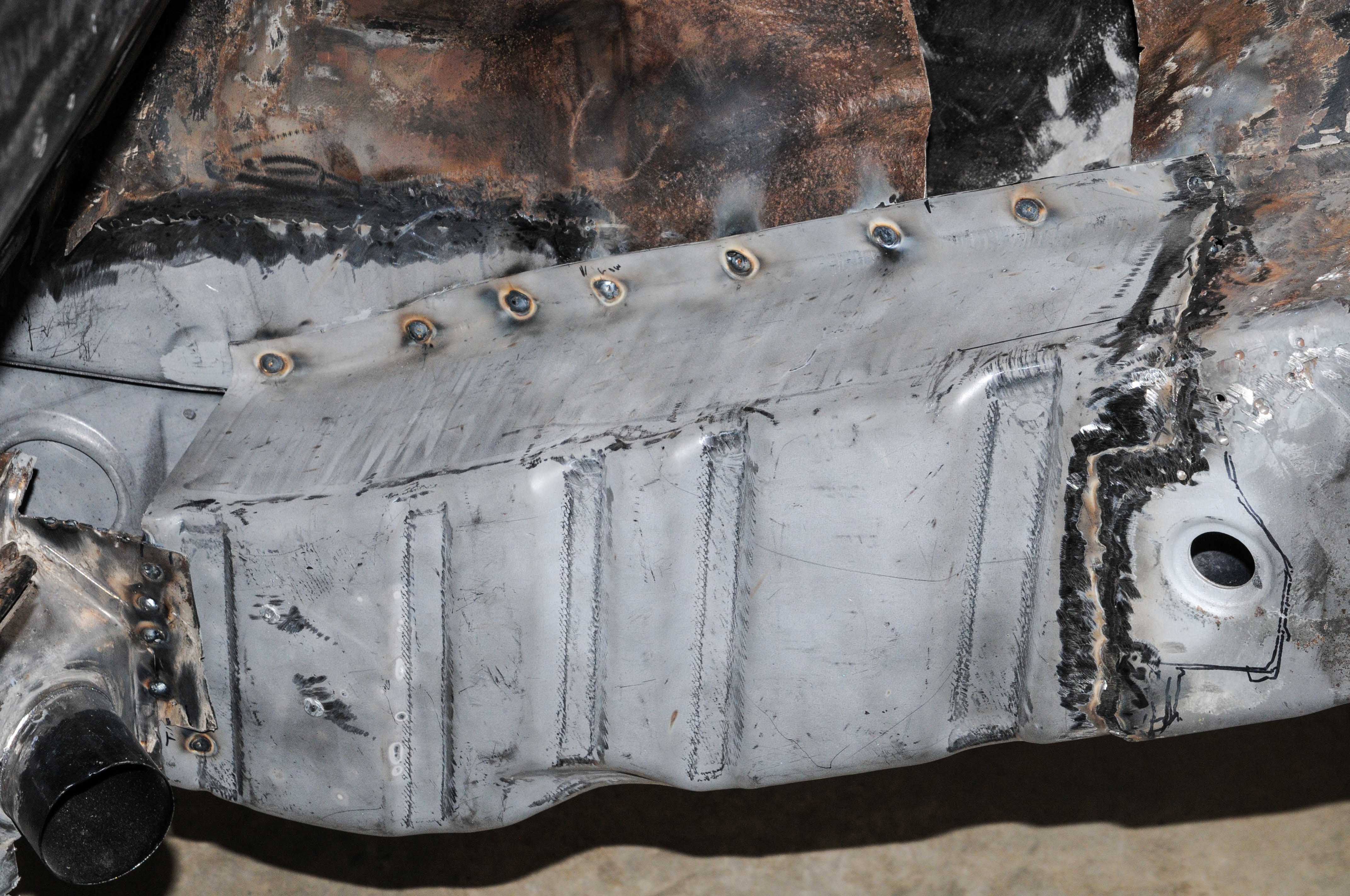

I am disappointed in myself that I worked half days all last week and had a 4-day weekend but only managed to work on the 914 one day... My excuses are that I got an injection in my knee one day, spent 2 doing Christmas stuff with the wife (Die Hard marathon included), was sick 1 and straight up lazy another. So today was spent welding the scariest part back into the car after 8,000 measurements to ensure squareness and one of those half days at work spent talking to a coworker who was a licensed welder before he enlisted. So here it is, the engine compartment long welded in after welding in the wheelhouse without cutting the fender! The welds were ugly, but had perfect penetration, and welding in my little brace/strengthener/stiffener thing was mostly blind and done as a contortionist exercise (I missed a few of the holes). I also decided to use some pop-rivets on the underside one (it kinda weaves over and under) to hold the piece down where I couldn't get a good clamp on.
On another note, you can see where I made my zig-zag cut. I did this to keep as much original metal as possible and also because I theorized that the added edge area allowed for greater seam strength.
Next week is another week of 3 day workweek of half days (another knee injection Wednesday though) and then another 4-day weekend that I hope is productive...
