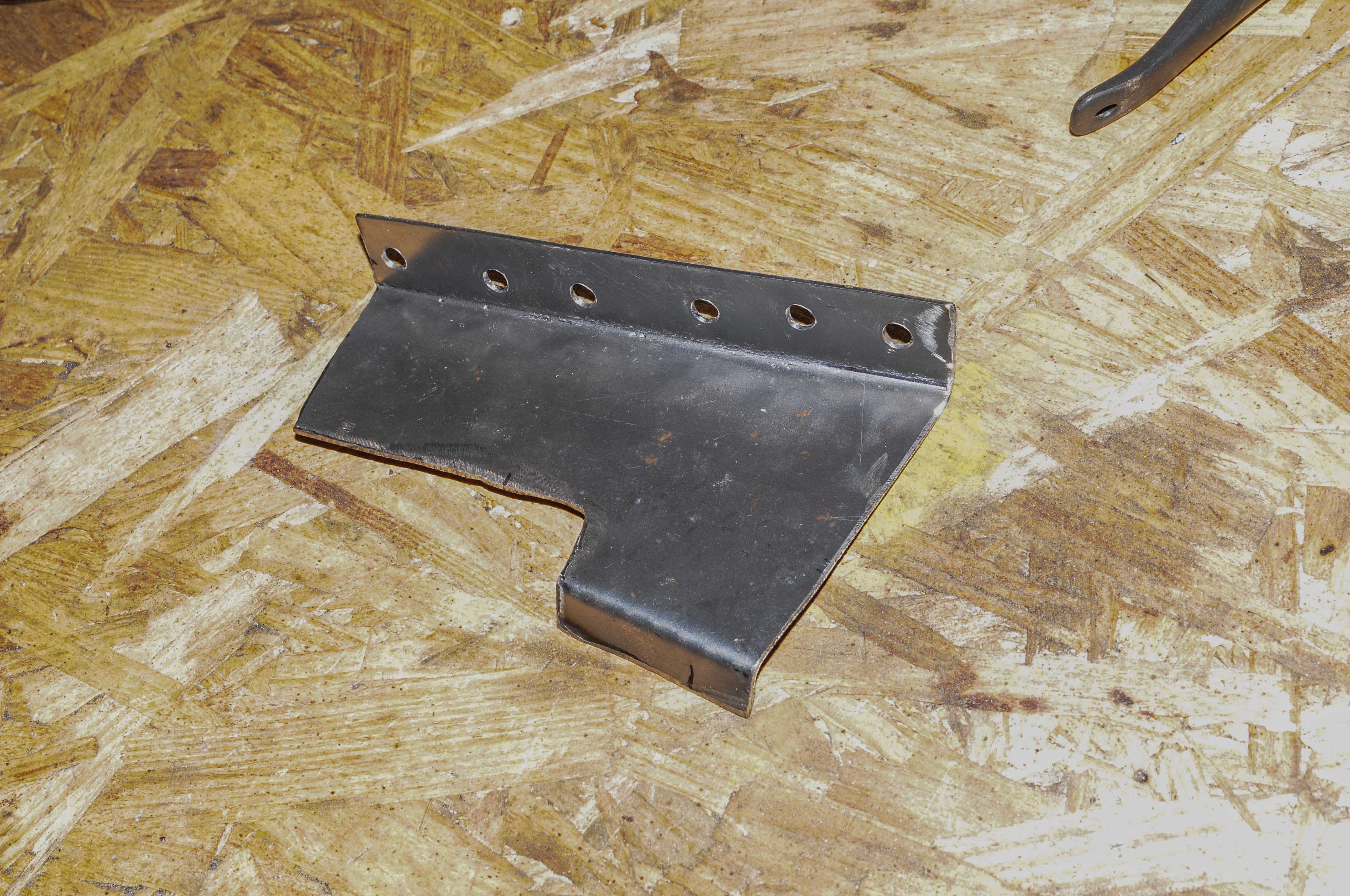

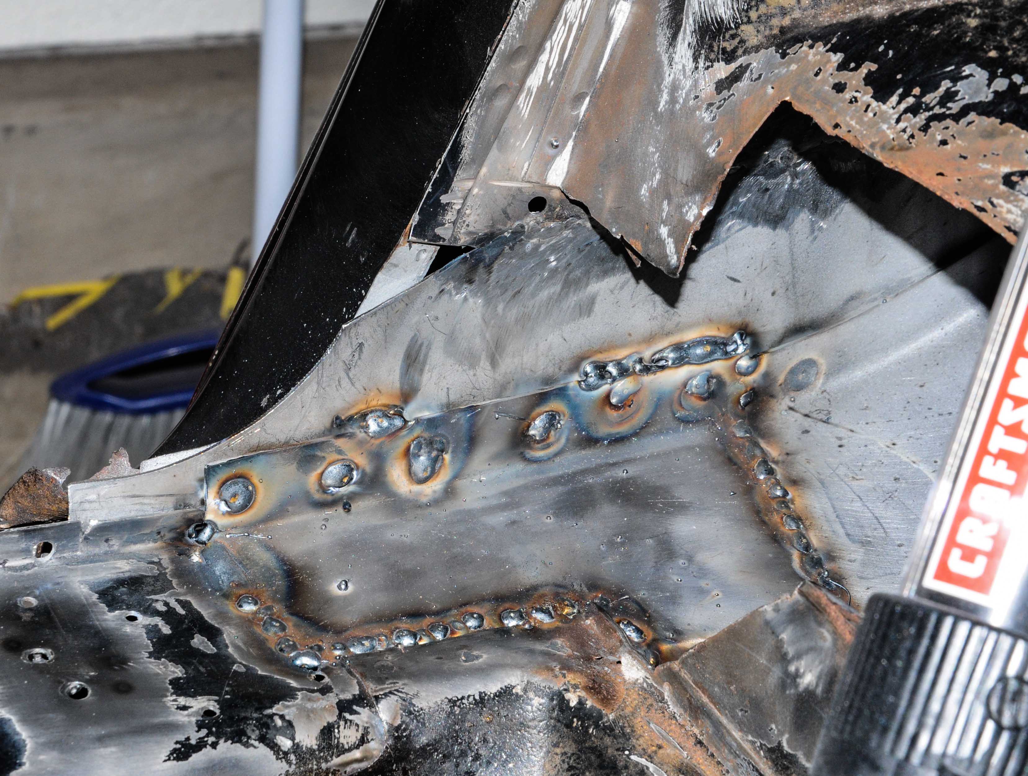

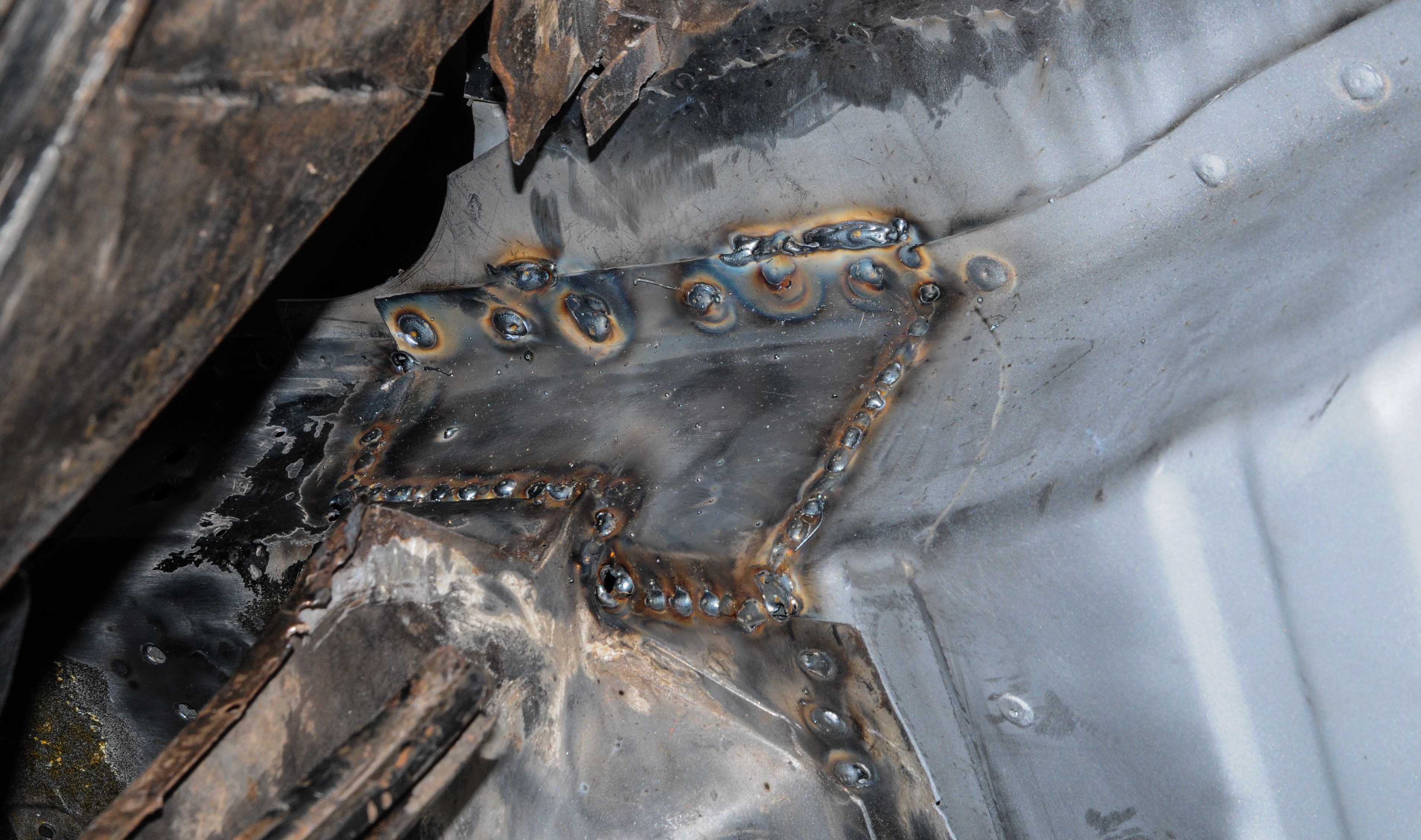

So today's short work was spent making a little patch piece from 16 ga steel and then welding it into the long area where it meets at the firewall. I got a little overconfident with heat (some warpage), especially where I ran the little bead. I got great if not perfect penetration in my ugly welds with only a few burn throughs (exactly where I expected them) by the firewall's remains. At the top edge you can see my aborted "big idea" of welding along that edge...I realized it'll be really hard to grind there...
I feel pretty confident in the strength of these welds and the long in general, I guess the first real test will be when I hoist the girl up onto the rotisserie in the coming weeks.
