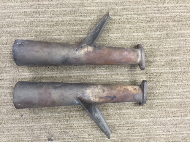

mb911   Any feed back on the 914-6 vs 4cyl muffler bracket...   Dec 29 2015, 06:23 PM
Travis Neff   914-6 headers and OE heat exchangers can use the 2...   Dec 29 2015, 06:26 PM
mepstein   Make up something cool from ss. I have an England ...   Dec 29 2015, 06:41 PM
Travis Neff   and by 2.0, I mean the 4 cyl 2.0 bracket   Dec 29 2015, 07:17 PM
Travis Neff   If you wanted to do something cool, one that would...   Dec 29 2015, 07:18 PM

mepstein   England hanger   Dec 30 2015, 09:15 AM
Mueller   England hanger I'd ditch the welded-on stif...   Dec 30 2015, 09:23 AM
mb911   Looks like I have c.. So the question is the heigh...   Dec 30 2015, 12:45 PM

jmill   Looks like I have c.. So the question is the heig...   Dec 30 2015, 04:49 PM
jmill   England hanger I'd ditch the welded-on sti...   Dec 30 2015, 04:55 PM
mb911   Picked up the engine today thanks John. Going to b...   Dec 31 2015, 02:40 PM
JmuRiz   They aren't the same, the heights are differen...   Dec 31 2015, 02:52 PM
mb911   They aren't the same, the heights are differe...   Dec 31 2015, 03:00 PM
Luke M   You would need a 914-6/914 2.0 bracket . There...   Dec 31 2015, 05:25 PM
jmill   OK, I thought I had a couple of 2.0 muffler hanger...   Dec 31 2015, 06:10 PM
Luke M   OK, I thought I had a couple of 2.0 muffler hange...   Dec 31 2015, 06:16 PM
mb911   OK, I thought I had a couple of 2.0 muffler hang...   Jan 4 2016, 03:34 PM
jd74914   Thanks for the info. I will mod my mount and sta...   Jan 4 2016, 09:21 PM
mb911   Thanks for the info. I will mod my mount and st...   Jan 5 2016, 06:11 AM
