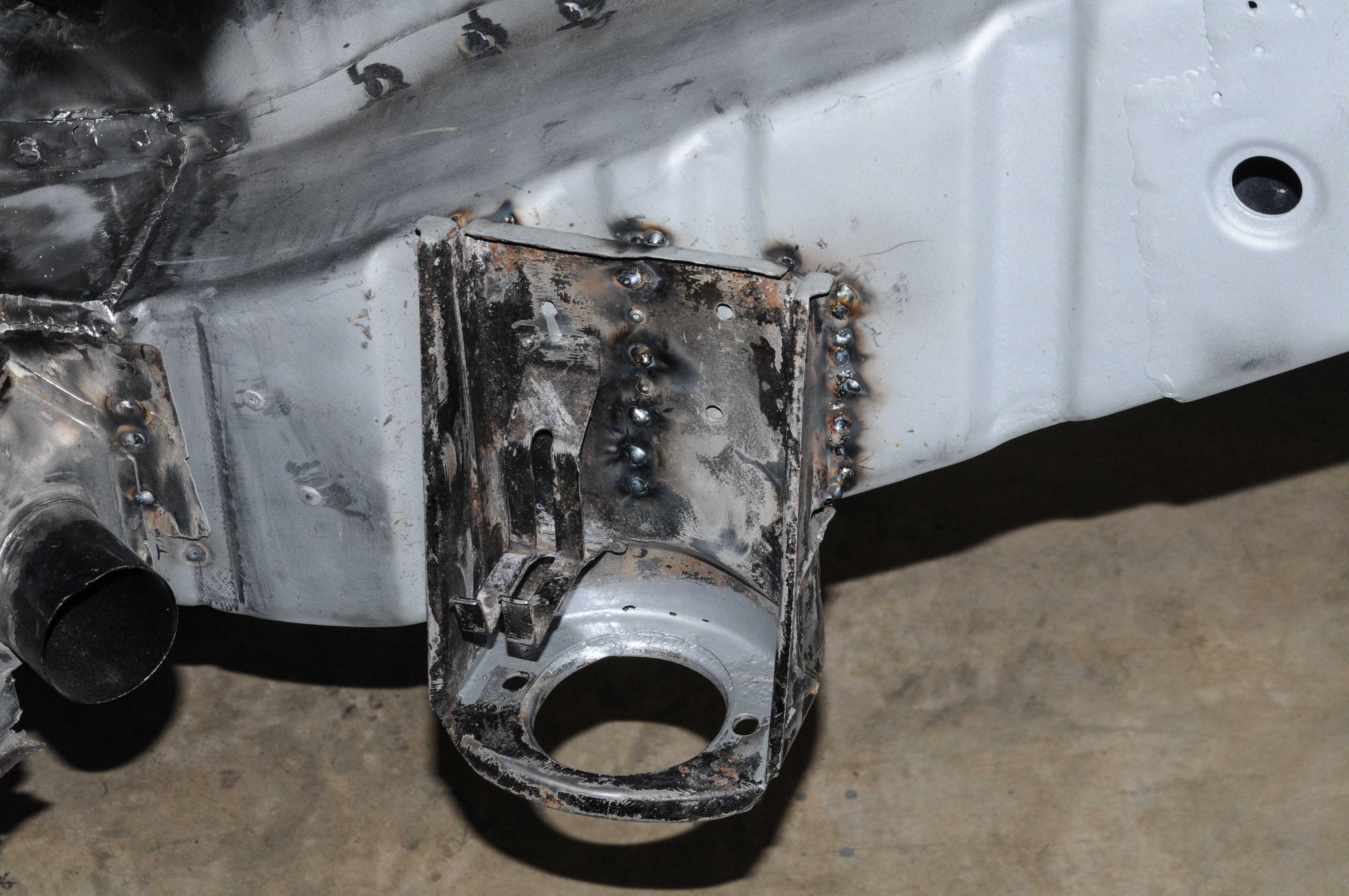

It took a while to get it measured out and then held in place (I used little pop-rivets to hold it in place), but I put the motor mount console thing on. Super ugly welds (par for the course) but I was really surprised at the ones on the firewall side, which were done half blind with my left hand...
