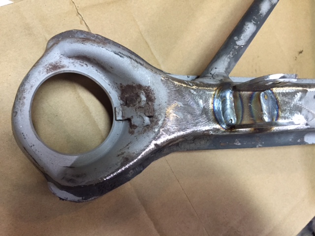

I welded new swaybar tabs on the 911 front control arms and then sent all of the suspension pieces out to be powder coated.

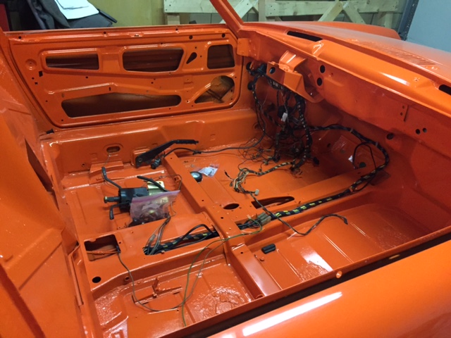

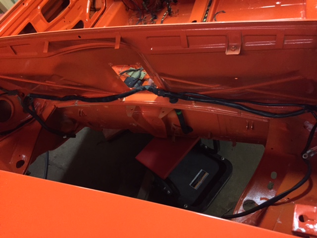

I am starting the reassembly process which entails cleaning and installing the wiring harness.
Cleaning parts is taking a lot longer than anticipated but it will be worth it in the end.
