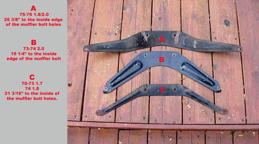

Anyone know what the difference between a 1.7/ 1.8 muffler bracket? I remember they can simply be redrilled but been 15 years since I have done that..
Here's and old pic from the board:
Looks like making a SS bracket like a 2.0 hanger and/or straps would be a better solution.
