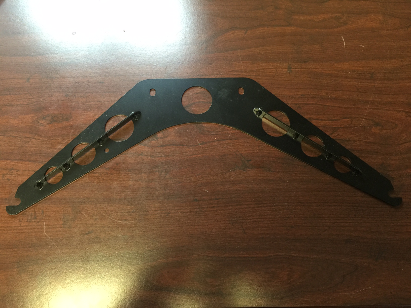

post Dec 30 2015, 09:23 AM
914 Freak!
Posts: 17,155
Joined: 4-January 03
From: Antioch, CA
Member No.: 87
QUOTE(mepstein @ Dec 30 2015, 07:15 AM) *
England hanger
I'd ditch the welded-on stiffener and use dimple dies instead reduce flexing in that part.

mepstein   England hanger   Dec 30 2015, 09:15 AM
Mueller   England hanger I'd ditch the welded-on stif...   Dec 30 2015, 09:23 AM

jmill   Looks like I have c.. So the question is the heig...   Dec 30 2015, 04:49 PM
jmill   England hanger I'd ditch the welded-on sti...   Dec 30 2015, 04:55 PM
