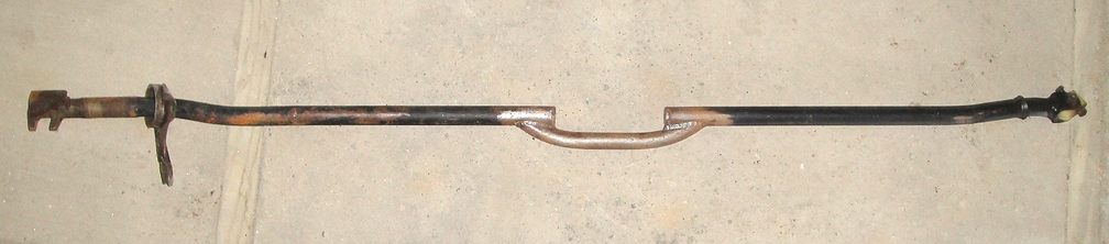

I got this shift rod at the same time, it allows for an early 911 aluminum
case engine to fit in a 914-6 and clear the casting on the bottom of the engine.
