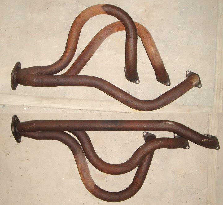

Any chance you can make some simple ones like these in stainless ?
Gary

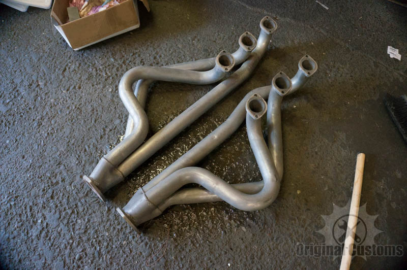

QUOTE(gandalf_025 @ Dec 30 2015, 03:51 PM) *
McMark has a set left over from a -6 install he is doing for me: stainless headers. As far as I know he did not sell them before his move.
(IMG:http://www.914world.com/bbs2/uploads/post-419-1435270877.jpg)
