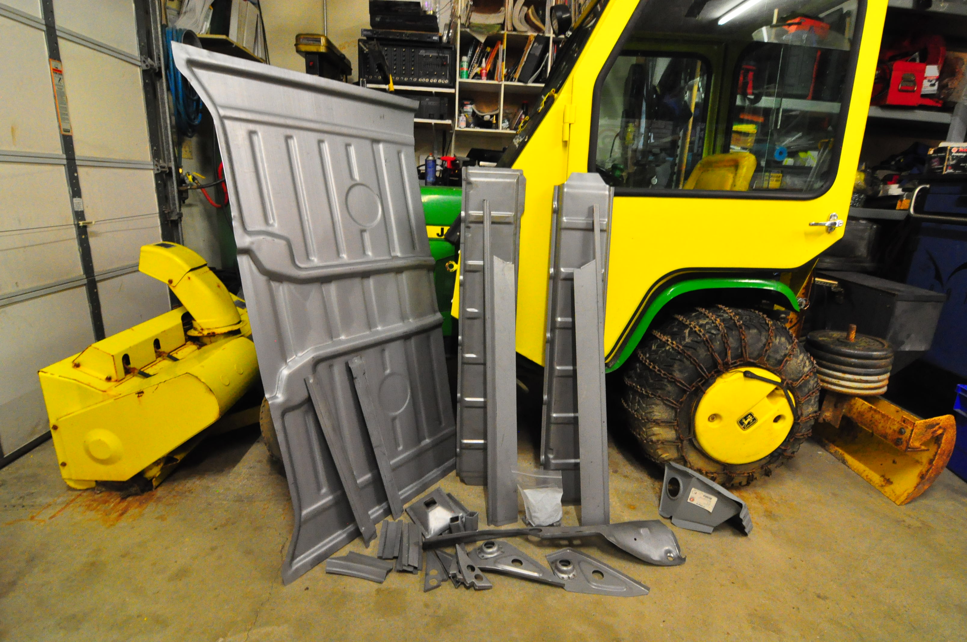

I spent most of the month working on determining what parts to replace, which ones to buy and which ones to make. I received a nice shipment from Restoration Design and I have another order in with them and with Pelican and both of those should be here next week. I’m confident that next month’s report will show significant progress as my plan has been to start patching in January.
Speaking of patching, I counted over 30 patches on this car that were done (and done poorly) by the previous owner(s). Every one of those will need to redone or replaced by new panels. So, as far as what challenges were encountered I would have to say that getting the car soda-blasted revealed a lot more body work problems than I, or anyone else who looked at this car, expected to find.
