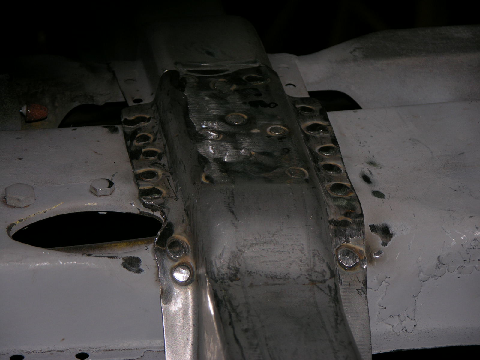

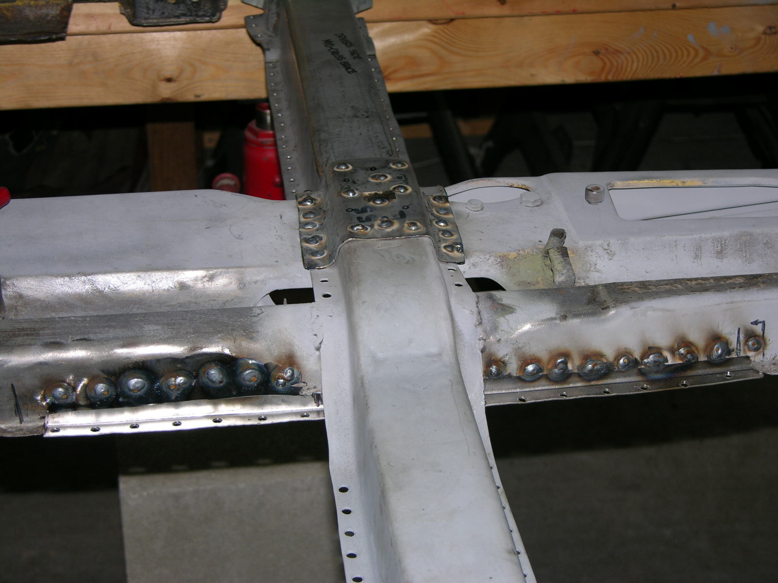

Driver's side Mid Tunnel Repair piece
Pass Side Front Firewall Repair
Pass Side Front Tunnel Repair Area
Pass Side Tunnel Repair Piece Fabbed Up
Both Pieces Welded in and Rough Grinding done
Clutch Tube strengthening, looked at the original and created this with 16 gaugeAttached Image
Fit-Up of Driver's Side Middle Brace (Restoration Design Piece 355L)
Fit-Up of Pass Side Middle Tunnel Repair
Right after initial welds to both
Grinding done
I think that will hold?

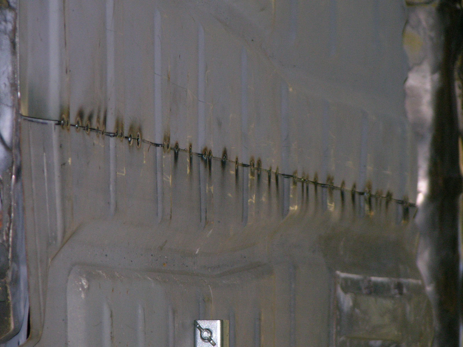

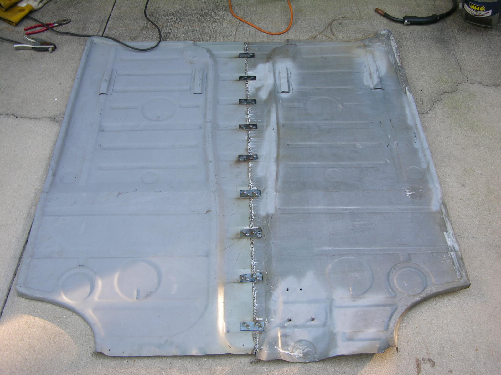

Initial Fit-Up and tack down of Floor Pans done in place. Please note the Cleco's doing their job they are the best!
Once tacked we were able to rotate the rotiserrie and then start to stich the seam
together
I called in the BIG GUNS for this job!
Dr. Kristoph Kinzli many of you may be familiar with his amazing thread on Pelican called "Saving the Rat" a 66 page journey about his beautiful 1969 911T that he found in a field in Northern New Mexico. Kristoph took the car through an amazing transformation and drives it to his Engineering job at Florida Gulf Coast University on a daily basis. I cannot thank Kristoph enough as his enthusiasm has helped me to get going on my project. He has 3 children under the age of 2 so he is very busy, we did get a lot done on Monday Floor pan wise though.
We did a lot of stitch welds on the seam but also decided to add some 16 gauge plates along the flat ribs to just OVER-Engineer it a little! (IMG:style_emoticons/default/welder.gif)
Kristoph was loving the chance to get some welding time in!
Prior to grinding down the seam
