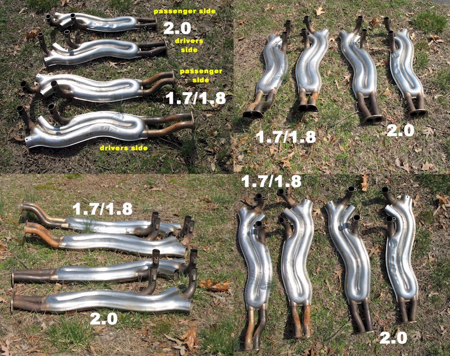

They aren't the same, the heights are different for the 1.7/1.8 and 2.0
See the rise in the heat exchangers on the smaller engines:(IMG:http://www.914world.com/bbs2/uploads_offsite/bowlsby.net-50-1451595169.1.jpg)

QUOTE(JmuRiz @ Dec 31 2015, 12:52 PM) *
That's not good. Now I need a measurement so I can modify what I have to be able to get to work
