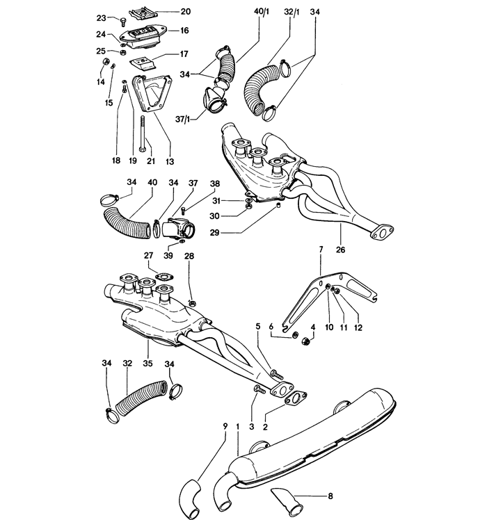

You would need a 914-6/914 2.0 bracket . There's a few different 914 4 styles early to late it changed again IIRC.
Pic shows the 914-6/ 914 2.0 bracket.

mb911   Any feed back on the 914-6 vs 4cyl muffler bracket...   Dec 29 2015, 06:23 PM
Travis Neff   914-6 headers and OE heat exchangers can use the 2...   Dec 29 2015, 06:26 PM

Travis Neff   and by 2.0, I mean the 4 cyl 2.0 bracket   Dec 29 2015, 07:17 PM

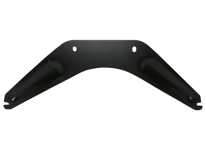

mepstein   England hanger   Dec 30 2015, 09:15 AM
Mueller   England hanger I'd ditch the welded-on stif...   Dec 30 2015, 09:23 AM

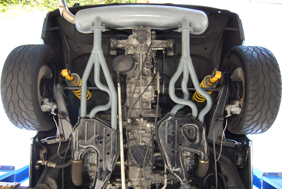

mb911   Looks like I have c.. So the question is the heigh...   Dec 30 2015, 12:45 PM

jmill   England hanger I'd ditch the welded-on sti...   Dec 30 2015, 04:55 PM
