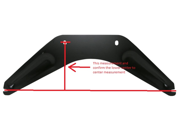

OK, I thought I had a couple of 2.0 muffler hangers I could give Ben. I don't. I must have gave them away or put them somewhere I wouldn't lose them. (IMG:style_emoticons/default/rolleyes.gif)
Ben needs some measurements. Can someone with a 2.0 muffler hanger give him the center to center measurements in the picture below. If a couple of guys pipe in and confirm them, even better.

I have one off my 6. I'll go out and measure it in a few.
20" c to c on header flange mount, 5" c to c on trans mount holes, 6 1/4" c to c from trans mount down to center flange line.
