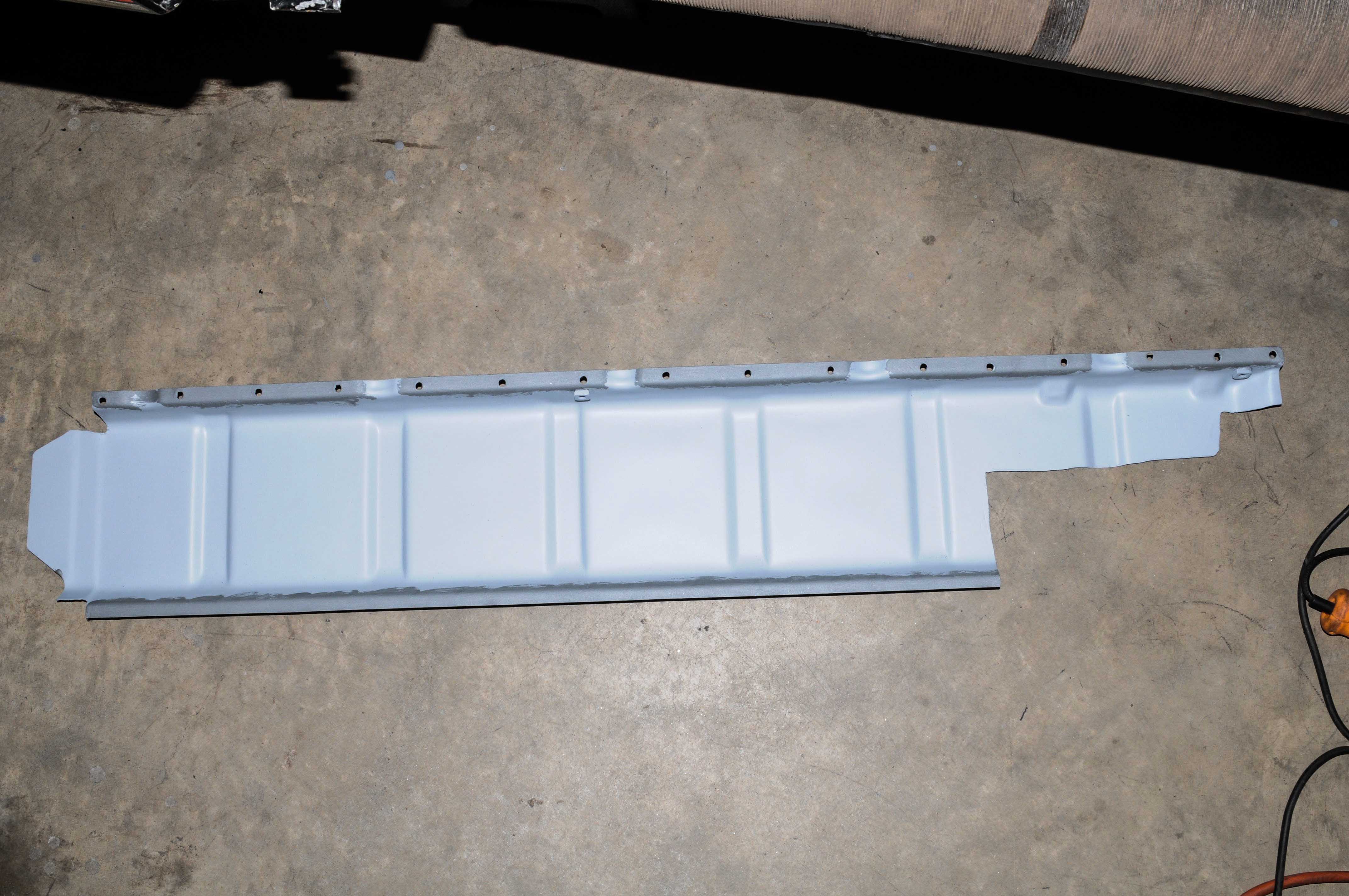

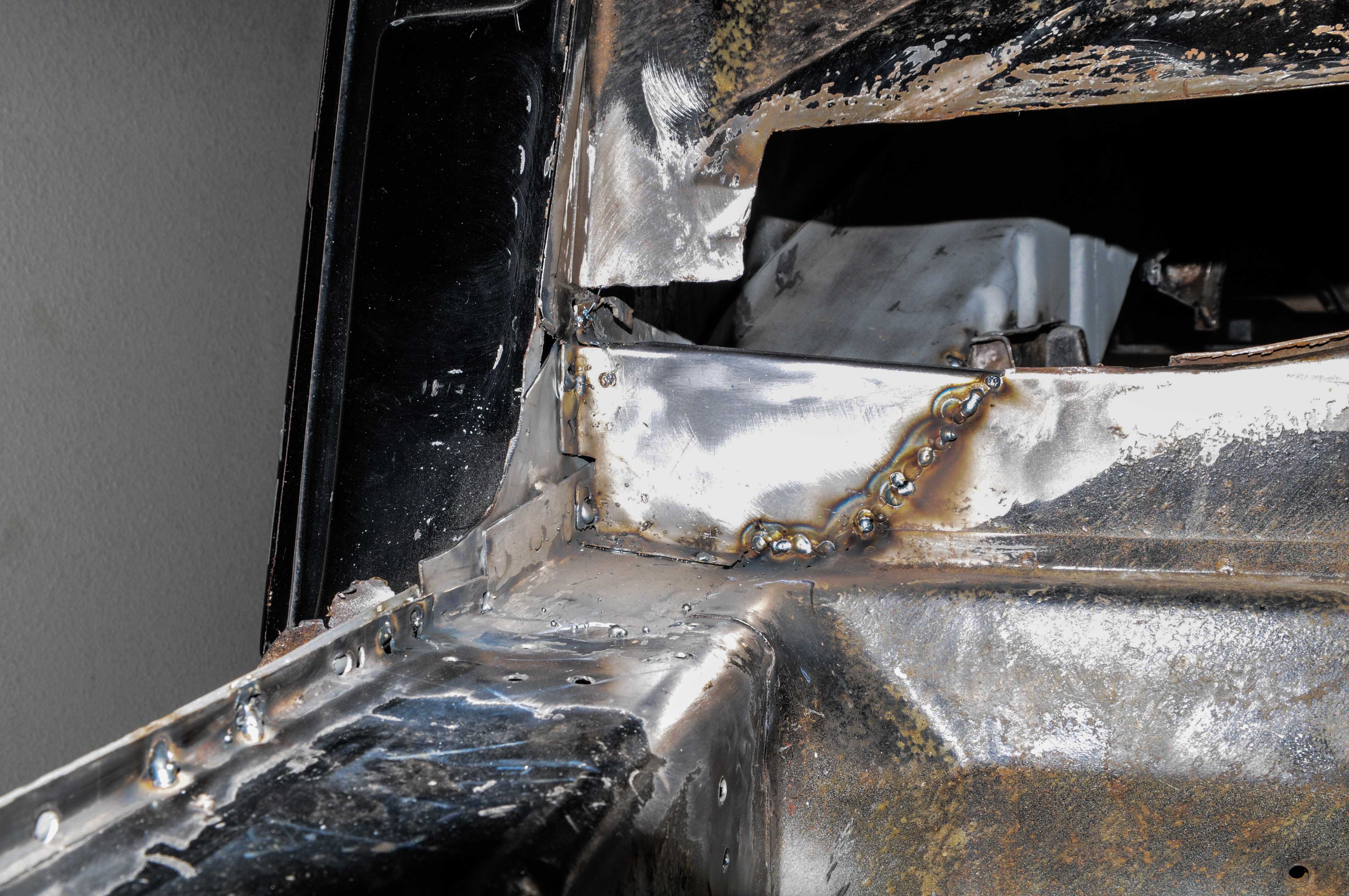

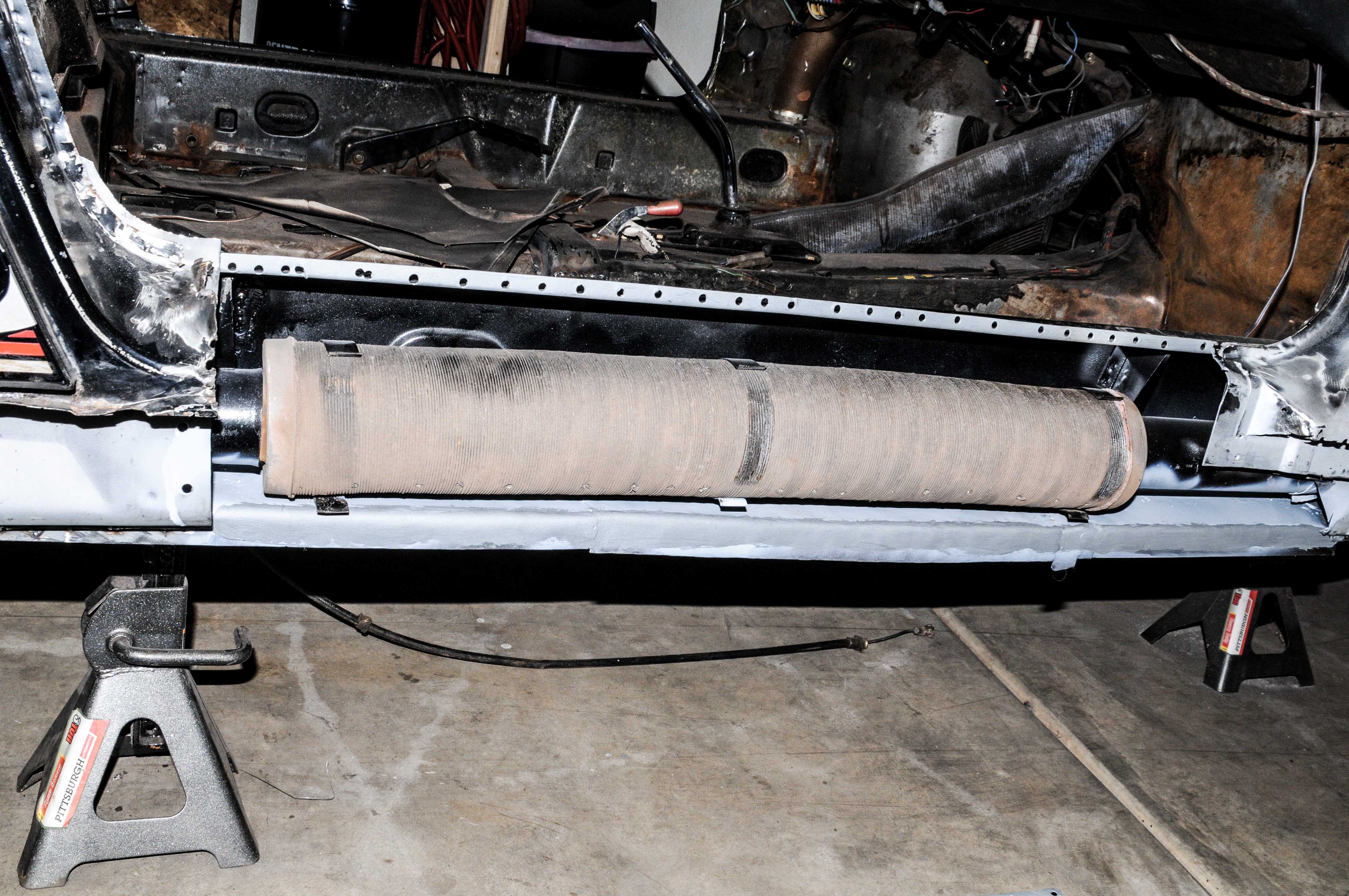

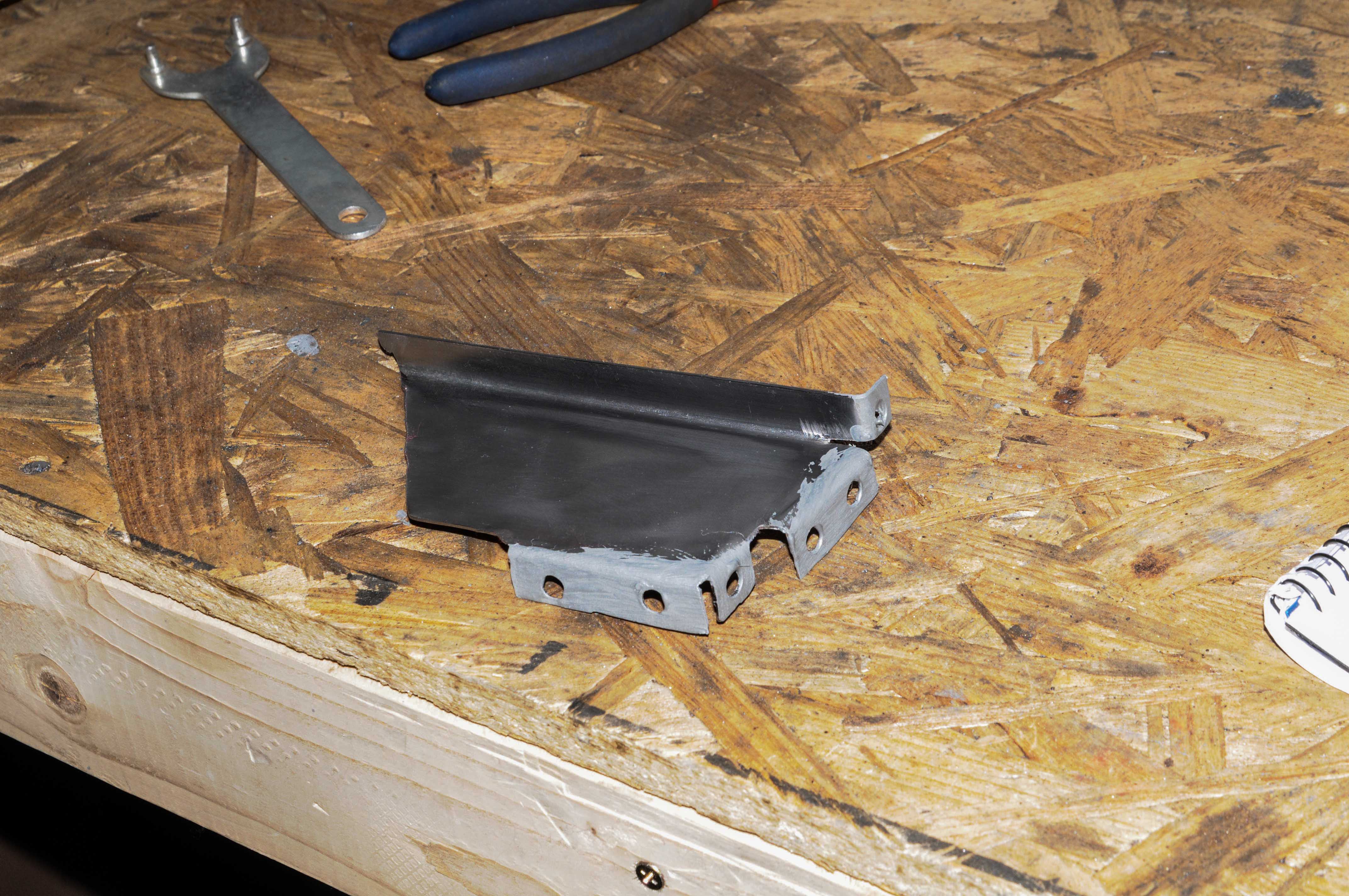

Today was a big day in that I closed up the passenger side long! I tried a different weld-thru primer and had some splatter issues, and some burn through problems... I think I was a little excited.
But the really exciting news is that I got the dude up on the rotisserie and it didn't break in half! I then had to enlist the wife's help and we spent 4 hours trying to get the whole thing balanced. It's almost there so I haven't got to go full loop yet, only about 60 degrees each way, but after one or two more adjustments tomorrow it will be on like Donkey Kong. I can already tell that the rotisserie is going to make this job waaaay easier than my previous experiences.
