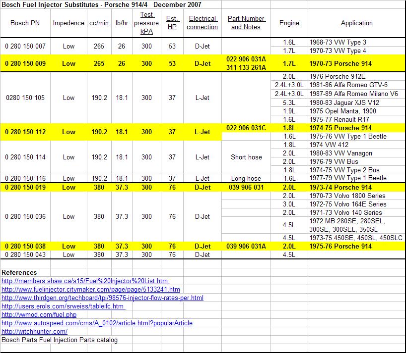

Lots of different injectors - dependent on the ECU and other sensors, specific to each vehicle. If you are putting together a correct 1.7L FI system here is a guide:

Jeff Bowlsby   Lots of different injectors - dependent on the ECU...   Jan 3 2016, 03:51 PM
