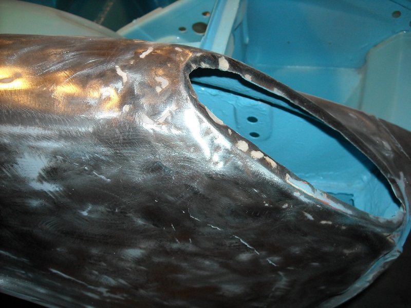

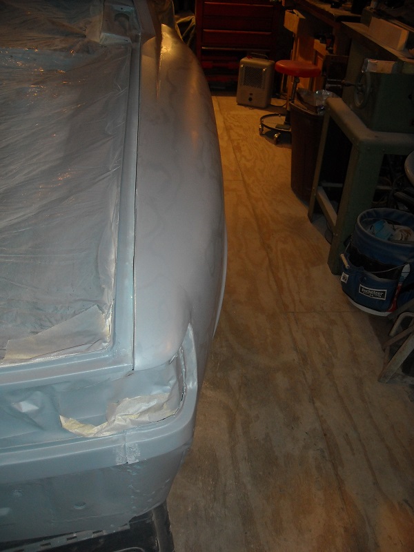

Time for an update to this.
the bodywork is coming along.
front fender shaping up.
from this.
to this, the flares are very subtle. I like the way its turning out
Still not perfect though
and the rear quarter is shaping up also. this is just rough shaping.
from this angle you can see how much it flares out. I'll be fitting 8'" Fuchs under here.
still working on getting the fender lips right though.

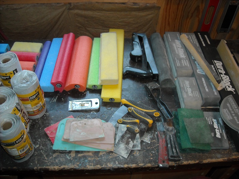

Along the way I am accumulating a lot of body work tools
a bunch of Dura blocks and soft blocks
and a shitload of sandpaper.
too bad the tools don't have magic built into them. you still have to know how to do it.
I am sure a lot of experienced bodymen could do a better job with kitchen utensils though.
