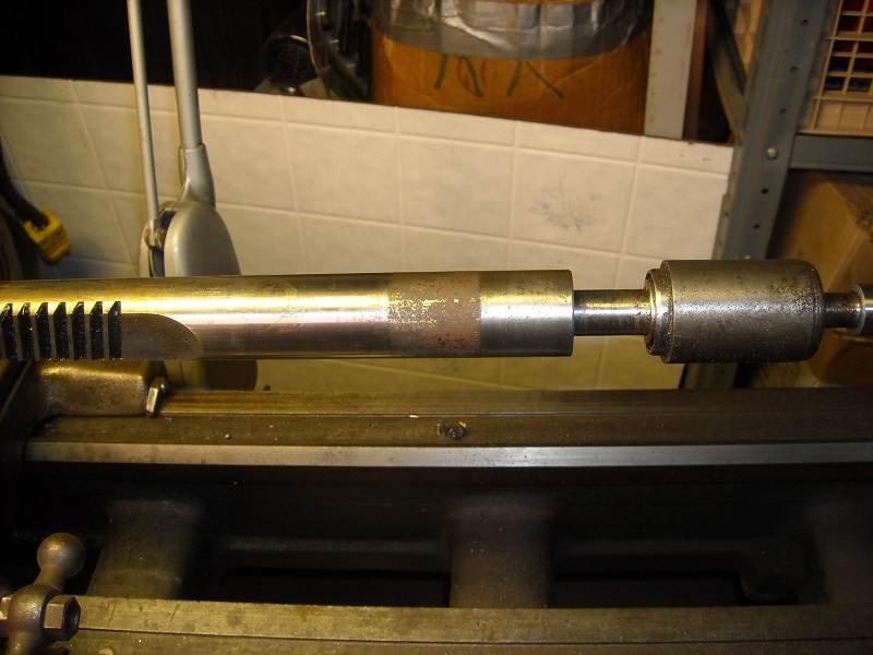

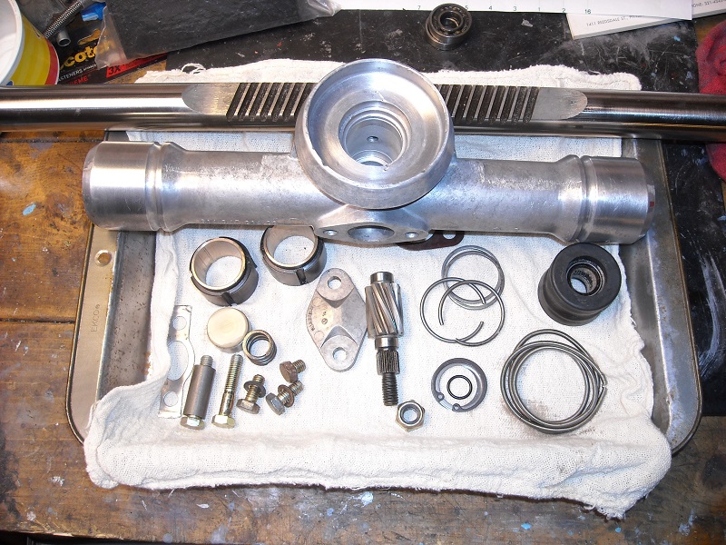

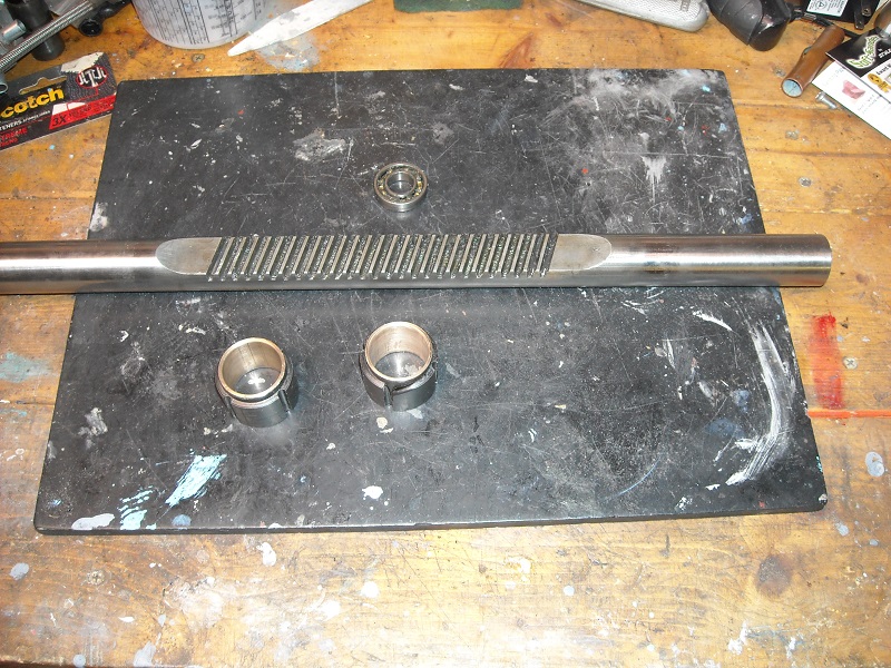

with the cold weather I am now working on some mechanicals.
stuff I am more comfortable with.

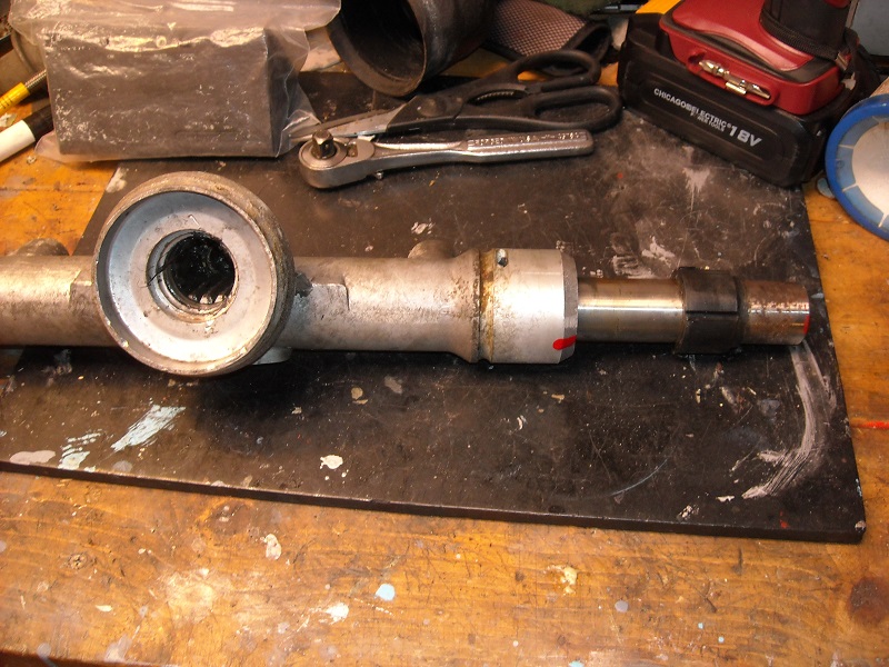

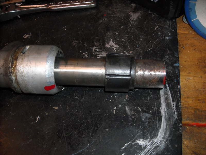

went to put on the turbo tie rod ends and found out that the one side steering rack bushing was really stuck on there. looks like some moisture got in there and rusted it up ( Imagine that, Rust. )
after a bunch of PB blaster, and a soak in kerosene, I decided to try a little heat.
after carefully heating up the rack rod, and some persuasion with a deadblow hammer, not wanting to ruin the NLA end bushings I finally got it to move off the rack. the lathe and some emery cloth to polish the rack helped a lot.
It cleaned up pretty nicely, also put the emery cloth to the rack end bushings.
it all looks good now. just waiting on the bearings I ordered to come in and I can put every thing back together.
