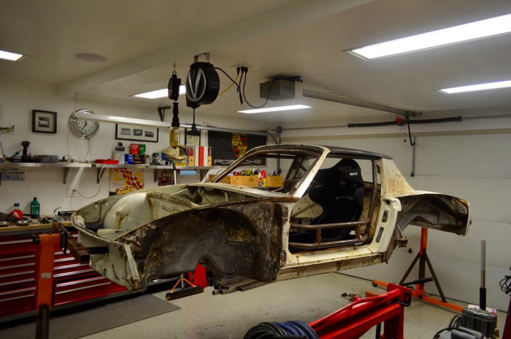

Brought the chassis into the garage, she's finally out of the elements and the real work can get started.

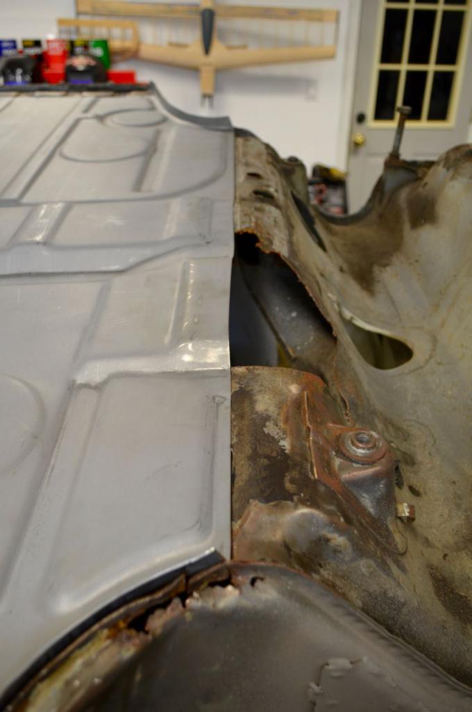

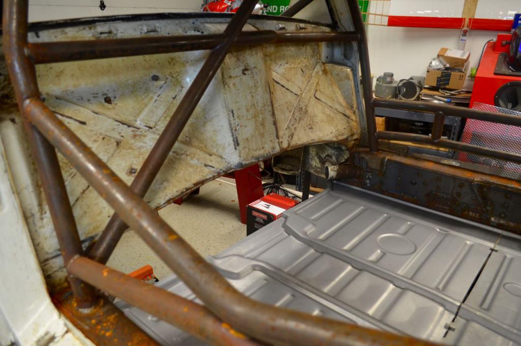

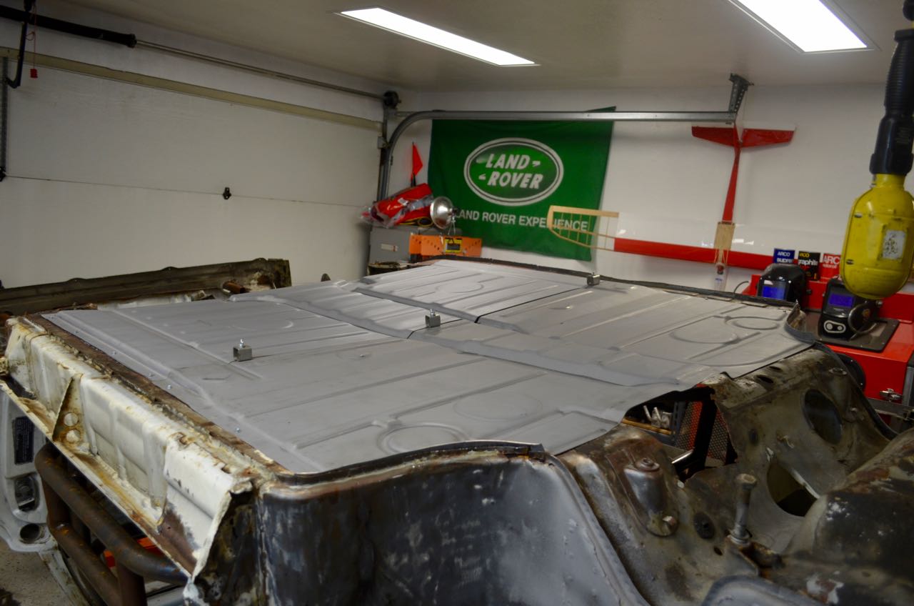

I've started test fitting the front and rear floor pans. Don't sweat that rear pan placement, I found out I was doing it wrong AFTER screwing it down. No worries, it's not permanent.
Fitted the seat, looks like its going to work. Im still planning to drop the seat pan down by 2" and I need to get busy on the custom tunnel.
Im investigating drivetrains (likely EJ205) and pedal clusters this week and will be picking up the Rennspd bodywork in February, excited to get my hands on it all.
Also thinking about gusseting the front hoops of the cage to the A-pillars. Does anyone have an opinion on it?

914forme   Unless you tie in the roof, you are only gusseting...   Jan 27 2016, 06:33 AM
