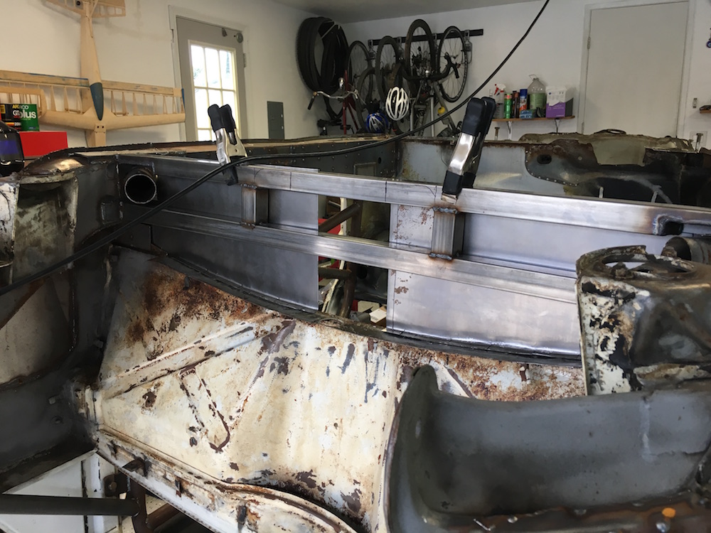

Where sits today:
I picked up the car in May and I've since then I've put it on a home-built rotisserie, cut the pans, tunnel, trunk, headlight buckets, and front fenders out of it, and fixed the hell-hole area.
The pans were totally rotted, the battery tray was nonexistent, the fenders on all 4 corners had damage. Pretty easy to make the decision to start fresh, haha.
Today, most of the chassis kit is installed but I can't finish it until the roll-cage is put in. Tangerine is almost done with the cage so it'll be another week or so until I see it.
In the meantime, the plan is to clean up the wheel-wells, fix the rust in the longs, put in the trunk cross-sections, and primer the reinforcements.
Then I'll get to work on the tunnel, mod'ing the pans, installing the fiberglass, etc.

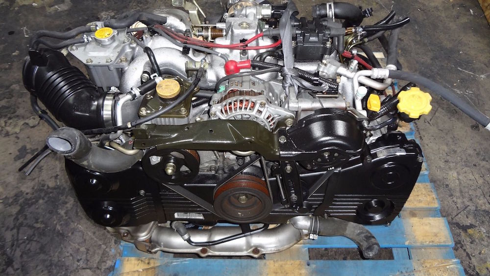

Bought the motor and trans this past week. EJ205T from eBay. Great deal, couldn't pass it up.
Also started work on replacing the firewall that rotted away. Its coming along nicely and will be a good foundation for a center tunnel, for tying in the dog-ears, and for mounting the engine.

MichiganMat   Made some good progress recently: - Welded in moun...   Oct 15 2015, 09:25 PM

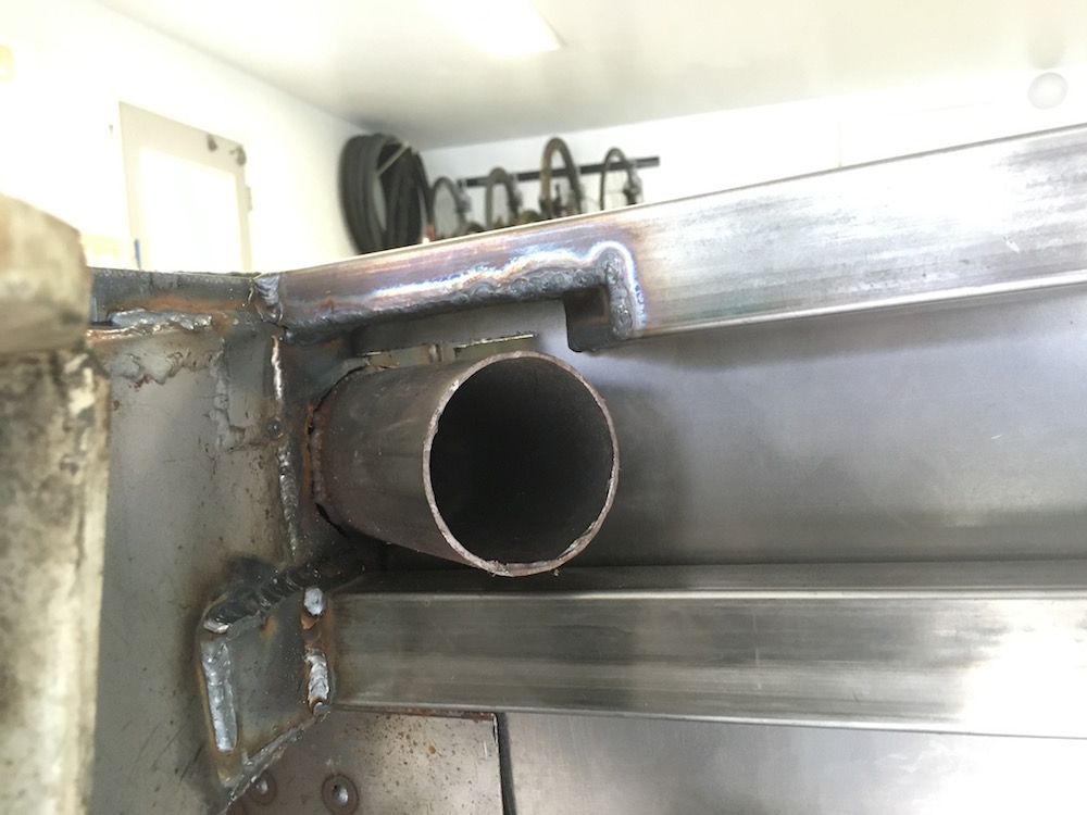

MichiganMat   Brought the chassis into the garage, she's fin...   Jan 26 2016, 02:49 PM
914forme   Unless you tie in the roof, you are only gusseting...   Jan 27 2016, 06:33 AM
