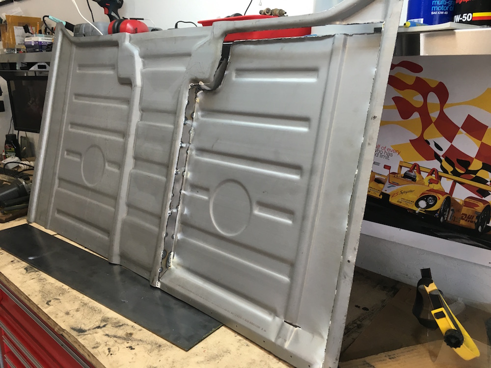

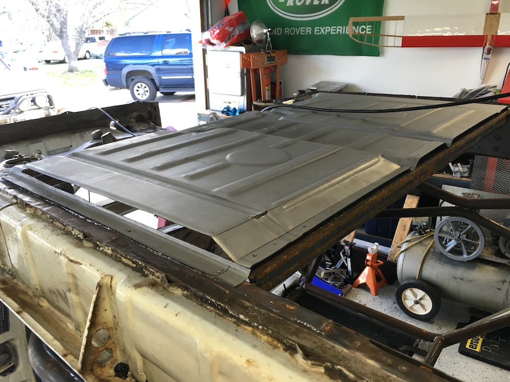

Today I worked on dropping the drivers floor pan down by 1 inch. Cut along the outside of the pan, made a few bends in the metal brake, and welded a 1" strip of 16ga around the perimeter. The goal is to get the driver seat nice and low, Im 6'1", need to get my helmet away from the top of the roof and below the roll cage. I've seen this done on a few of the Patrick Motorsports builds, seems like a well-known mod. I still need to figure out how to mount the seat brackets to the pan and decide if I'll use sliders or not. A few questions left to be answered...
I also started thinking about how to build the custom tunnel / shifter console. I have a few ideas but Im going to need more steel and welding gas. I'll likely start in on it next weekend after gathering parts. Its tough to fit anything without the seat mounted in :/ I need to pick up used shifter (seems like people are using Toyota MR2, I wonder if there are other options?) and a pedal cluster (thinking Tilton or Wilwood at the moment).
