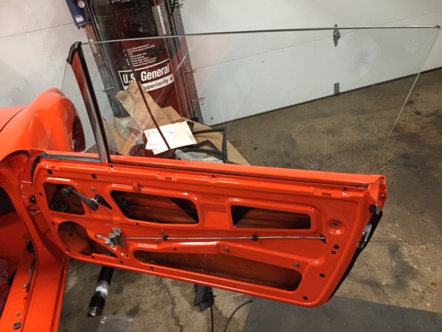

So far I have been able to assemble everything in the right order until this post. Can you find the assembly error that I made?

Darren C   Not installing the outer weather strip aluminium h...   Feb 1 2016, 12:24 PM
jkb944t   Not installing the outer weather strip aluminium ...   Feb 1 2016, 12:47 PM

Darren C   We have a WINNER! That didn't take long at...   Feb 1 2016, 01:31 PM
