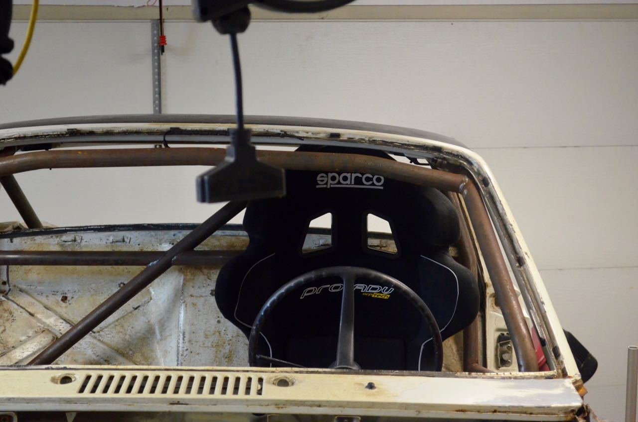

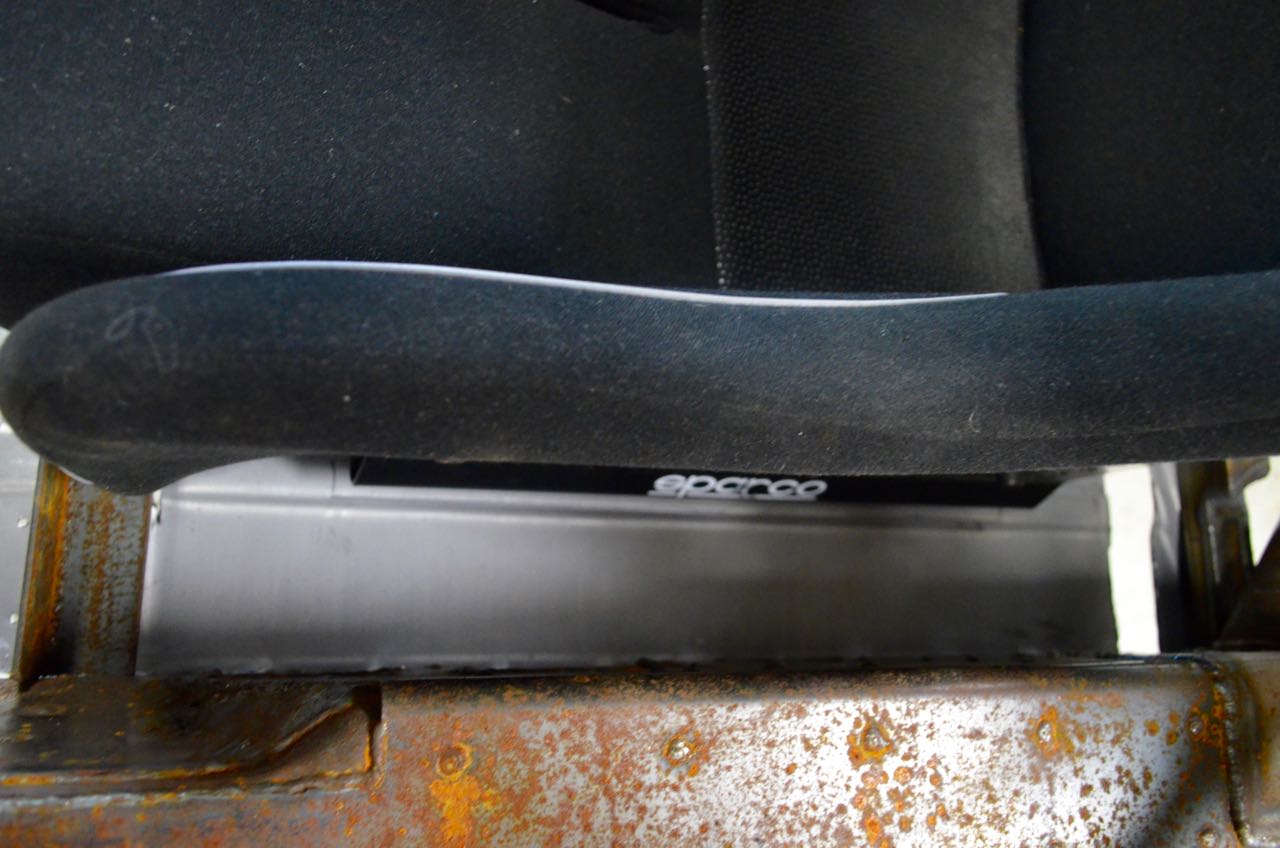

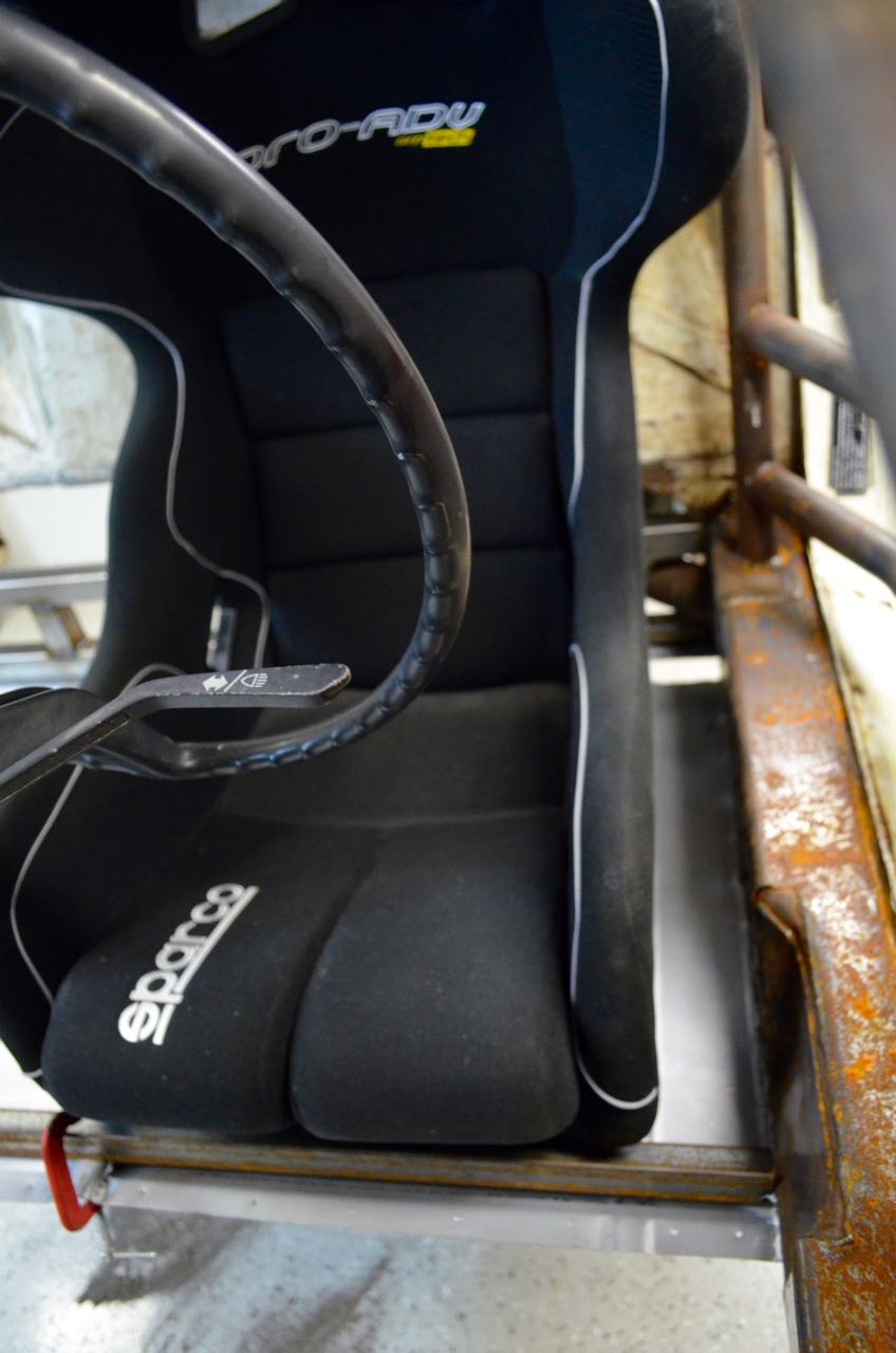

Ok, question for you guys: how aligned should the seat be with the steering wheel? haha, i kid.
I started lining up the seat last night and noticed the only way I could get a proper alignment of the seat + wheel is to move the seat towards the center so much so that its no longer sitting in the stock areas of the floorpan. This seems like a bug. Is this a common thing?
You can see in the pics that I've got the seat lined up nice and straight, but then look at where the brackets are sitting. Im already planning to make my own custom tunnel / shift console, so its not a big deal to me to mod the pan. I just want to know if Im headed down the right road here.
Is this correct? Thoughts?

siverson   Neat build. I can double check, but I don't th...   Feb 2 2016, 10:53 AM
