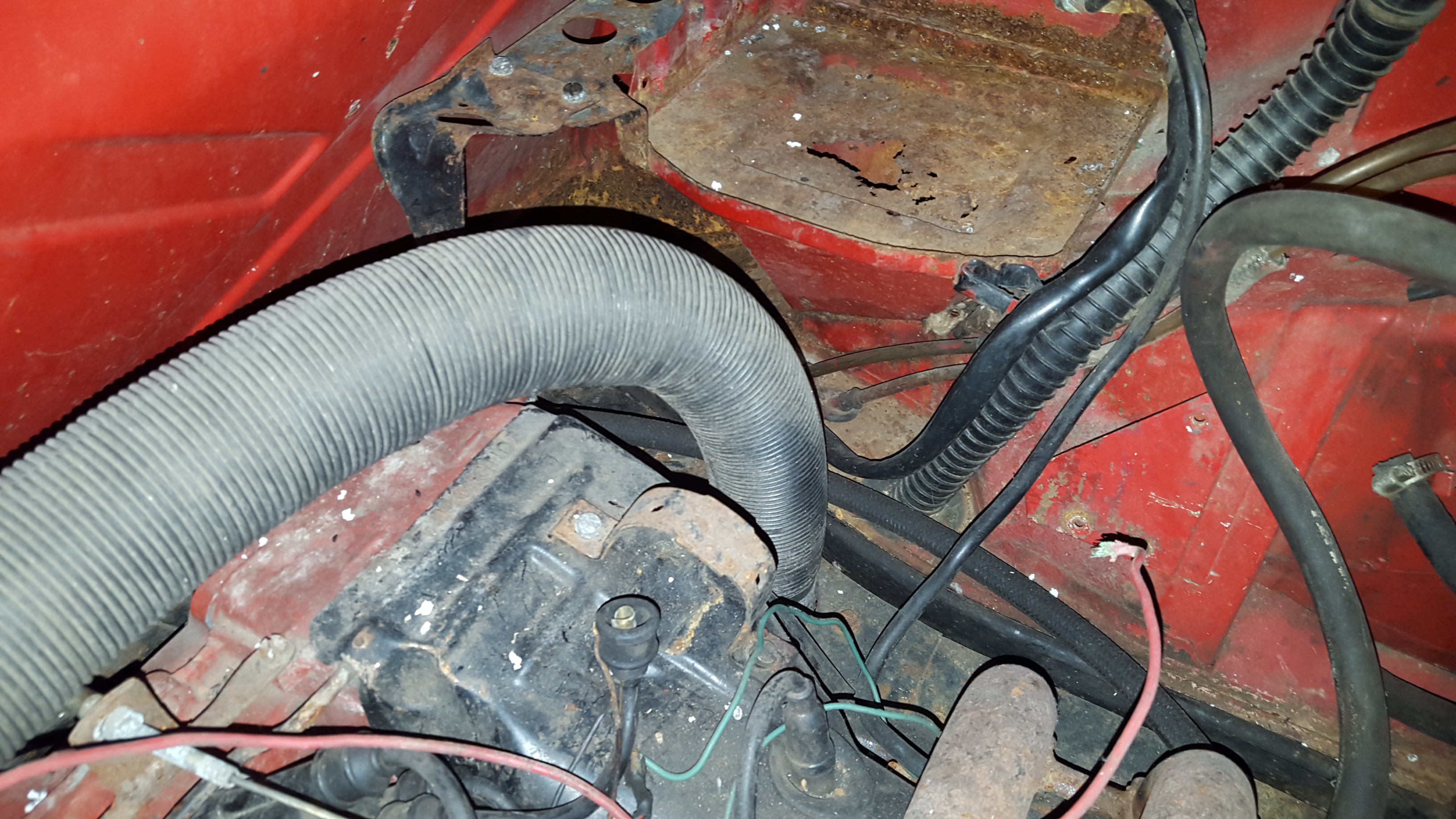

Here's the important picture. Seems to be a little bit of surface rust those pretty solid when I started poking at it underneath the battery tray. Car was purchased in 78 with 38000 miles on it. The woman who owned it paid $100 a month for 23 years to keep it in dry storage.
