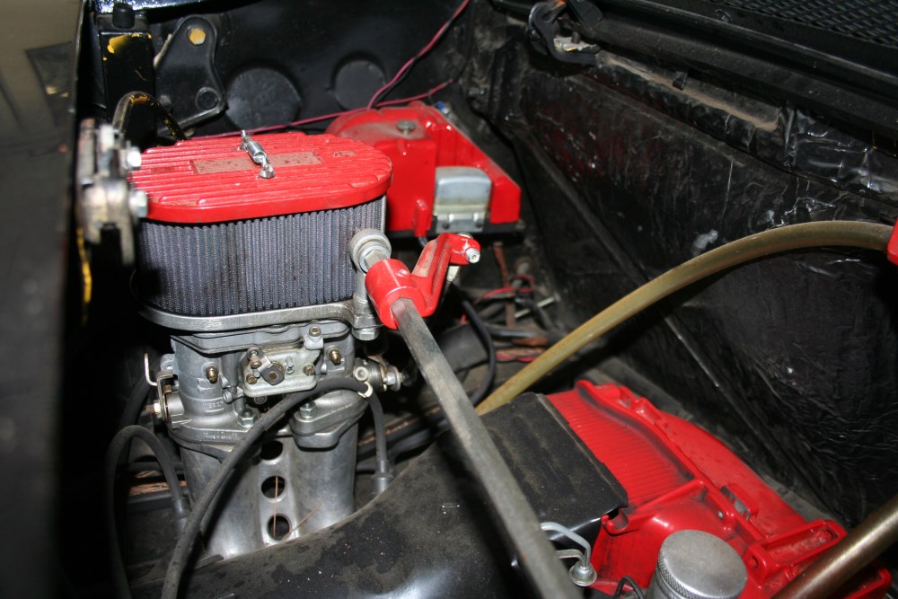

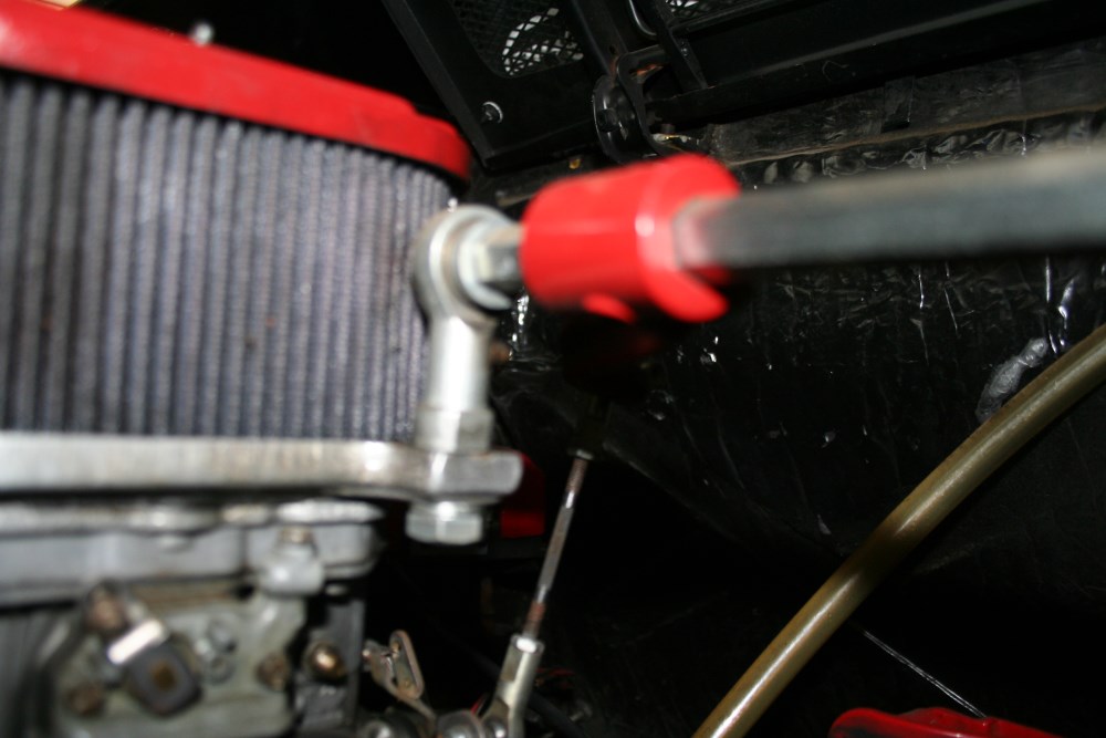

Nice, clean installation but seems to be a solution in search of a problem. IMHO. Normally, I would not disagree with Mark, however don't throw away the cross bar linkage. It can be modified easily. There was a thread on how to do this some years ago but I can't find it. I did mine and there is absolutely NO play in the linkage. Here's mine.

QUOTE(Elliot Cannon @ Feb 8 2016, 01:21 PM) *
Hate to tell you this, but I don't like your linkage.
For one in this pic the angle of the connecting arm puts a large thrust (side) load on the carb, it will cause premature wear.
A crossbar linkage can be done, but I rarely see one I feel is acceptable. Except for the Gene Berg for a type 1, I've never seen a good crossbar set-up out of the box.
(IMG:http://www.914world.com/bbs2/uploads/post-7407-1454955688.jpg)
