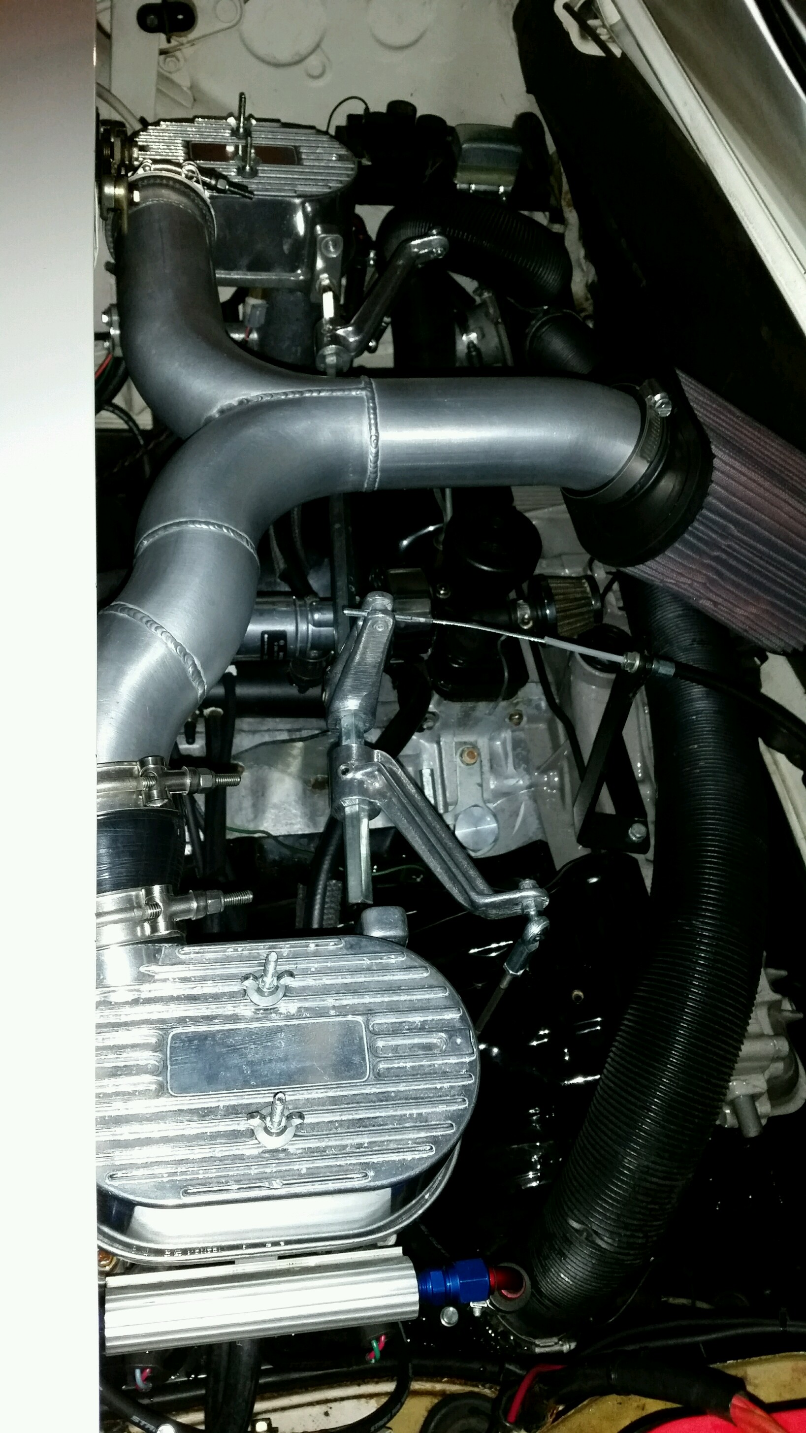

Mario, of the dub shop (thedubshop.net) fabed up an awesome intake for the 914. It looks great and now I can even hear the Tangerine Racing exhaust over the itb's. (IMG:style_emoticons/default/piratenanner.gif)

looks better that the cross bar for sure. I just can't bring myself to buy a $300+ Tangerine throttle linkage. looking for alternatives

jmill   Very nice. Now you can turbo it! :drivin...   Feb 7 2016, 01:29 PM
rhodyguy   How is the front of the tubing, near the filter, s...   Feb 7 2016, 04:12 PM
Mark Henry   Looks to me like CB Performance turbo system plumb...   Feb 7 2016, 06:09 PM
r_towle   Interesting, seems the cooling fan and the intake ...   Feb 7 2016, 06:51 PM
Mark Henry   Interesting, seems the cooling fan and the intake...   Feb 7 2016, 08:16 PM
porschetub   Interesting, seems the cooling fan and the intake...   Feb 7 2016, 08:58 PM
Series9   I think we have a new entry for "Top 10 Point...   Feb 7 2016, 08:19 PM
Andyrew   I think we have a new entry for "Top 10 Poin...   Feb 7 2016, 10:08 PM

URY914   So what is so special about it? What does it do di...   Feb 7 2016, 09:57 PM
wndsrfr   So what is so special about it? What does it do d...   Feb 7 2016, 10:11 PM
boxsterfan   Reminds me of: http://www.osintakes.com/ :)   Feb 7 2016, 10:53 PM
BeatNavy   Reminds me of: [url=http://www.osintakes.com/]htt...   Feb 8 2016, 08:11 PM
Mueller   Nice, I wouldn't expect any performance gains ...   Feb 7 2016, 11:06 PM
Mark Henry   I'd actually like to see something very simila...   Feb 7 2016, 11:57 PM
Jake Raby   The last time I did a comparative on a similar set...   Feb 8 2016, 09:48 AM
Mueller   The last time I did a comparative on a similar se...   Feb 8 2016, 10:09 AM
Jake Raby   The last time I did a comparative on a similar s...   Feb 8 2016, 10:12 AM
rhodyguy   Nuff said. Thanks jake.   Feb 8 2016, 10:16 AM
Elliot Cannon   Nice, clean installation but seems to be a solutio...   Feb 8 2016, 12:21 PM
Mark Henry   Nice, clean installation but seems to be a soluti...   Feb 8 2016, 02:41 PM

Harpo   What about the CSP linkage? It seems like McMark ...   Feb 8 2016, 04:54 PM
Elliot Cannon   My linkage has been like this for over 10 years. ...   Feb 8 2016, 07:57 PM
Series9   Trust me, if you take a little time to set up a CB...   Feb 8 2016, 08:29 PM
McMark   Trust me, if you take a little time to set up a C...   Feb 8 2016, 11:26 PM

matthepcat   Kinda seems like an intake for forced induction.   Feb 9 2016, 02:21 AM
edwin   Looks like one of my weekend projects from early l...   Feb 9 2016, 07:24 AM

rhodyguy   The shouldered bolts Elliot mentioned eliminate th...   Feb 9 2016, 07:59 AM
Series9   How about: Loose the ITBs, attach the intake dire...   Feb 9 2016, 08:06 AM
Mark Henry   How about: Loose the ITBs, attach the intake dir...   Feb 9 2016, 12:13 PM

Racer Chris   ... Throttle cable movement when transmitted thr...   Feb 9 2016, 10:33 AM
396   ... Throttle cable movement when transmitted th...   Feb 9 2016, 10:56 AM
Darren C   ... Throttle cable movement when transmitted th...   Feb 9 2016, 11:00 AM
DBCooper   Probably not, Chris, the coefficient of flow over ...   Feb 9 2016, 10:54 AM

Series9   MAP sensor signal is a definite problem with ITBs....   Feb 9 2016, 01:48 PM
Series9   That's cool, but the MAP sensor problem will o...   Feb 9 2016, 02:09 PM
