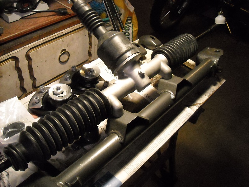

Got my bearings and finished the steering rack.
Rack rebuild thread

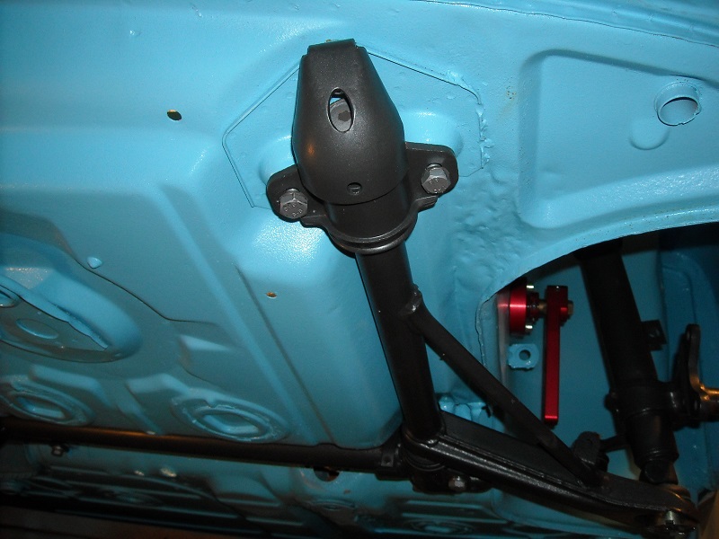

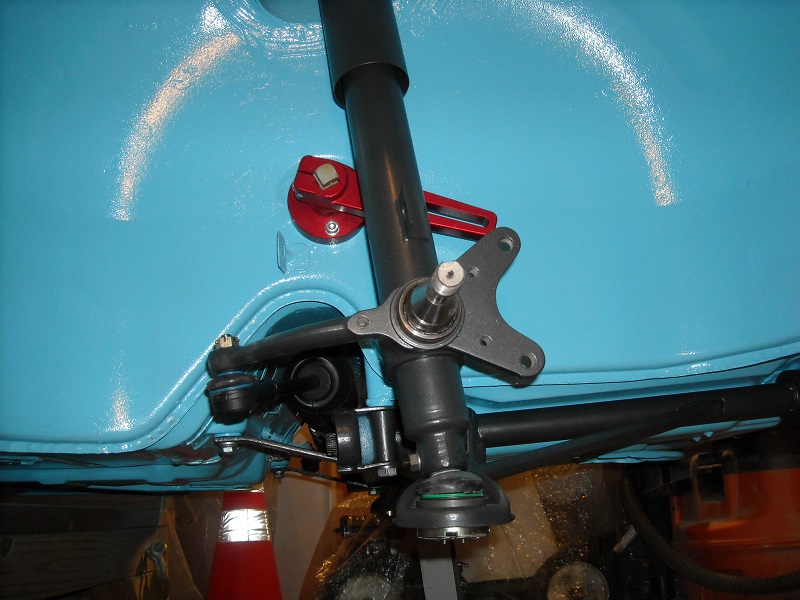

Since then I got most of the front suspension installed. still have to connect the sway bar. think I will start it at 1/4 from the soft position.
I know most people would finish the body work before starting to put stuff on. (IMG:style_emoticons/default/confused24.gif)
I like to do some mechanical work to get away from the bodywork for a little...
