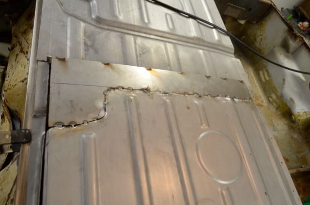

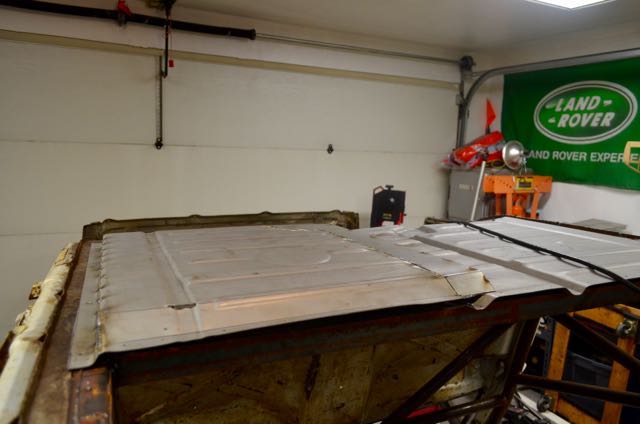

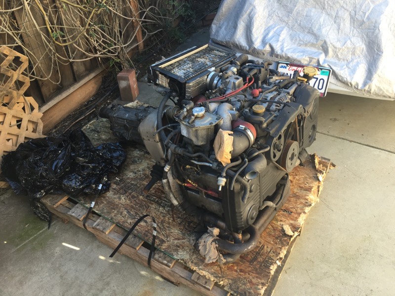

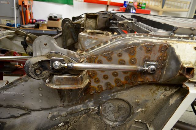

post Feb 8 2016, 08:54 PM
Posts: 115
Joined: 14-June 06
From: San Jose, CA
Member No.: 6,222
Another productive weekend!
I was able to get a bit more work done on the floorpan. I really had to cut out and drop a huge section to get the seat to line up, I really had no idea that the alignment was this bad in these cars. Oh well, the cuts are made, need to get in there and patch it all up, reinforce the lowered areas, and mount the seat sliders. Feels like good progress though.
I also did a bit of work on the rear suspension points. The inner points got a bit of reinforcement and I'll be adding a heim-joint connector from the dog-ear to the firewall soon. The reinforcements are not quite finished, I'll take some pics when its ready.
Oh, and I also fab'd up the outer rear suspension console adjusters / supports / etc. That was a neat job to do, and I really feel I saved myself a ton of money and trouble by doing it myself. Don't mind the surface rust (its ugly, I know), its all going away when I get the chassis media blasted.
Finally, the motor and trans arrived. Its a big dirty lump, but its here and its ready to go in. Excited!
