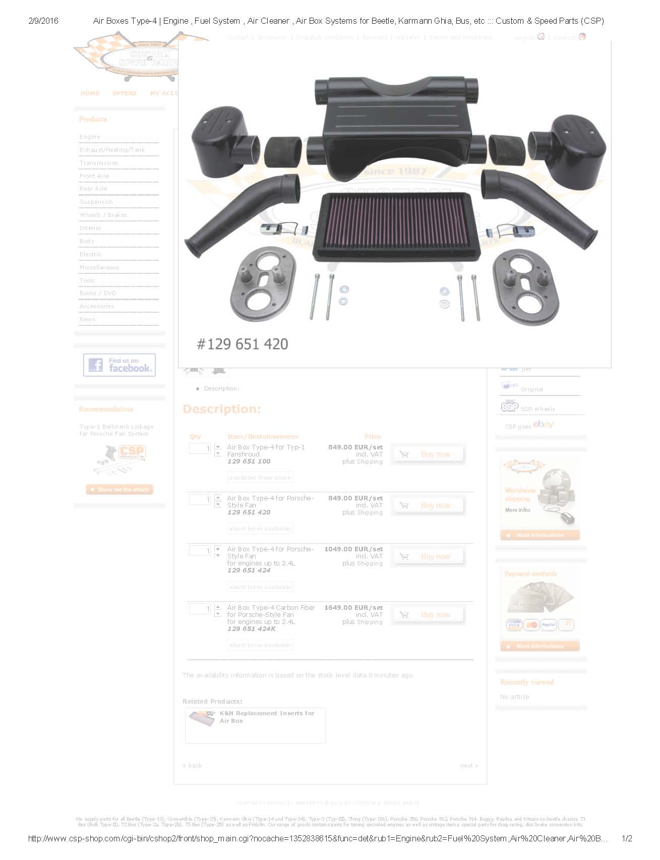

How about one of these? A little pricey but do they work?

I happen to love that setup and will eventually suck it up and buy it.
In Germany there are very strict noise pollution laws.
Imagine living near the autobahn, and in many villages they are quite close to it.
Cars going over 100 MPH make quite a bit of noise, especially late at night when there is nothing else making noise...and a howling car goes by.
That system from CSP really does help reduce the noise, and I believe it uses a fairly easy to obtain paper air filter...
