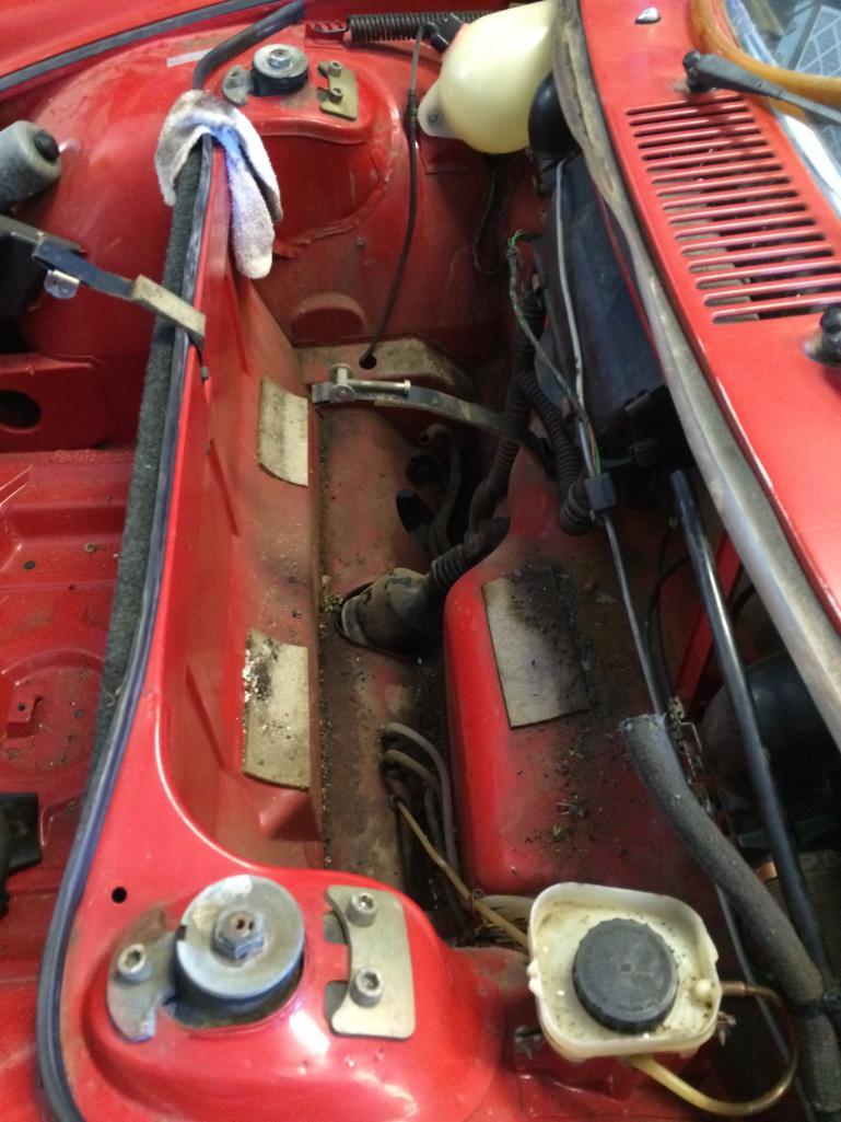

Matty900
post Feb 9 2016, 10:46 PM
Posts: 1,337
Joined: 21-February 15
From: Oregon
Member No.: 18,454
No rust just dirt
