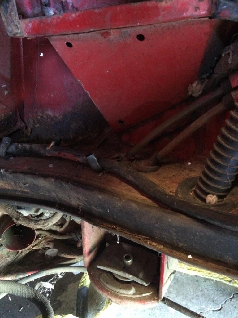

Matty900   I was able to get a better look at the car today. ...   Feb 11 2016, 01:44 AM
Matty900   I am not sure what rust issues I may have inside t...   Feb 11 2016, 01:48 AM
Matty900   Took off the rocker pannels and there was lots of ...   Feb 11 2016, 01:51 AM
Matty900   What is the best way to take care of this level of...   Feb 11 2016, 10:14 PM
