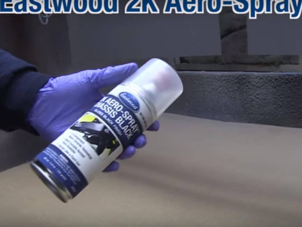

https://www.youtube.com/watch?v=3O-Ol2OmZxg
In your neck of the woods,a good choice in a one stop shopping trip is the Eastwood line of products.
Rust prepping,
rust neutralizing,
more prepping,
masking.
epoxy primer,
sanding,
masking,
more primer,
sanding,
masking,
color dusting,
color coating,
sanding,
buffing,
polishing,
gleaming.
A lot of work,you have to be prepared to be diligent in the details.
It's the why of automotive body and painting costs,a lot of work.
http://www.eastwood.com/paints/2k-aero-spray-paints.html
https://www.google.ca/webhp?sourceid=chrome...t+supply+oregon
Did I mention sanding?
First.
Try out your skills on a old rusted fender,2 square yards.
If you can,with the labor you supply,bring it back to a finish that everyone says is beautiful,why then proceed with the 914.
