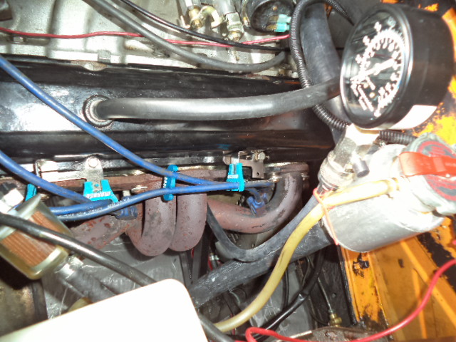

compression test of cylinder in question #4. the jump to 60psi is with coil wire still on dist cap. i then removed coil wire to dist cap and cranked it again. tried to rent comp tester from advance but they don't do that at my closest store. so I bought one for $29. seems a v8 spark plug is 14mm, go figure.

jimkelly   compression test of cylinder in question #4. the ...   Feb 10 2016, 10:10 AM
Justinp71   compression test of cylinder in question #4. the...   Feb 10 2016, 02:04 PM
Steve Pratel   compression test of cylinder in question #4. the...   Feb 10 2016, 02:44 PM
Justinp71   You need to compare that reading with other cyls...   Feb 10 2016, 03:03 PM
