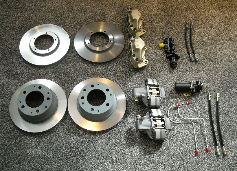

Cold out this morning.... 15 deg. to cold to work in an unheated shed..
Good time to unbox and inspect my new parts from PMB.
rebuilt 911 A front calipers, PMB repro 914 GT rear calipers.
Sebro vented rotors front and back.
rebuilt pressure regulator, new 19mm ATE master cylinder.
Damn those A calipers sure are heavy....
